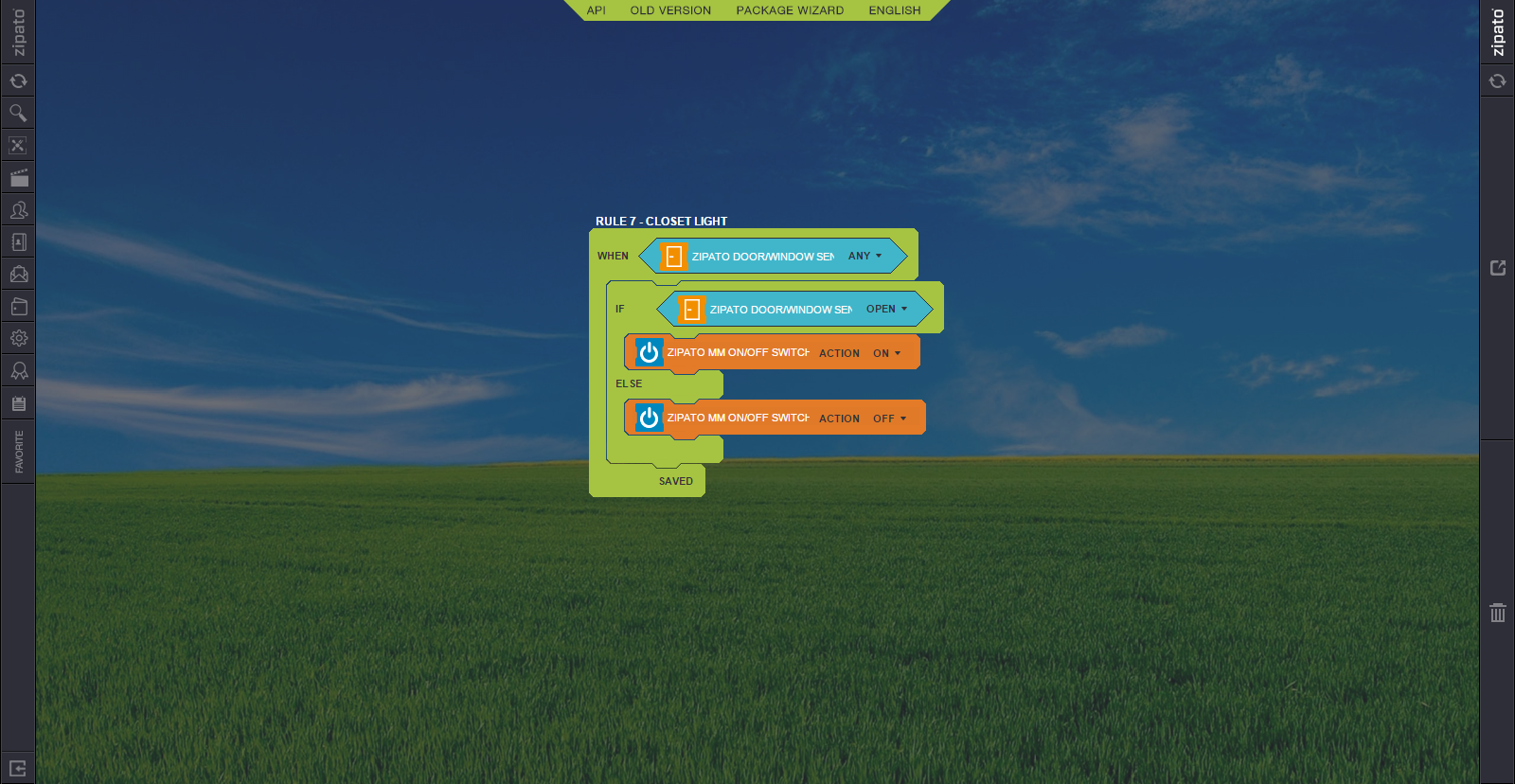

Then we created the following rules in the Zipato Rules Creator to control how the closet light would work. For more details see the "Introduction of Rules Creator" section.
This rule works as follows:
1. Main 'When' block wraps the whole rule. The rule is activated if the state of the Zipato Door/Window Sensor changes.
2. The 'If' condition is set when the Zipato Door/Window Sensor is in 'open' state.
3. The 'Action' block sets the Zipato MM Single Switch to 'on'.
4. The 'Else' condition is set when the Zipato Door/Window Sensor is in 'close' state.
5. The 'Action' block sets the Zipato MM Single Switch to 'off'.
6. Don't forget to 'Save' your rule and then to 'Synchronize' it at the end.
