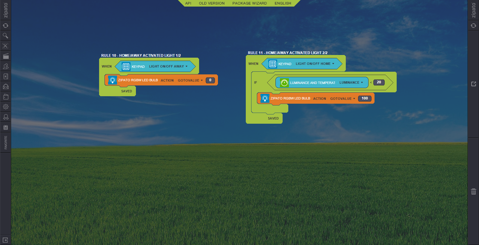

Then we created the following rules in the Zipato Rules Creator to control how the home/away activated light would work. For more details see the "Introduction of Rules Creator" section.
These rules works as follows:
Away (rule on the left)
1. Main 'When' block wraps the whole rule. The rule is activated if the Away button of the Zipato Mini Keypad RFiD followed by the corresponding code or a RFiD tag is entered.
2. The 'Action'block set the luminosity of the Zipato RGBW Bulb to 0.
3. Don't forget to 'Save' your rule and then to 'Synchronize' it at the end.
Home (rule on the right)
1. Main 'When' block wraps the whole rule. The rule is activated if the Home button of the Zipato Mini Keypad RFiD followed by the corresponding code or a RFiD tag is entered.
2. The 'If' condition is set when the luminance is inferior to 20%.
3. The 'Action'block set the luminosity of the Zipato RGBW Bulb to 100.
4. Don't forget to 'Save' your rule and then to 'Synchronize' it at the end.
