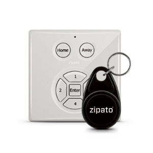

Zipato Mini Keypad RFID/Z-Wave - Adding
Device can use up to 20 codes, RFID reader inside, 1 RFID Key tag included, could be used within a security widget and rule creator, Z-Wave. Mini Keypad RFiD/Z-Wave’s indicator light will react differently on each action.
Features of Mini Keypad RFID/Z-Wave:
- Can arm/disarm a security system
- Can read Mini Keypad RFID/ZWave-tags
- Has the possibility for the user to manually insert codes
- Indicator light will react differently on each action
