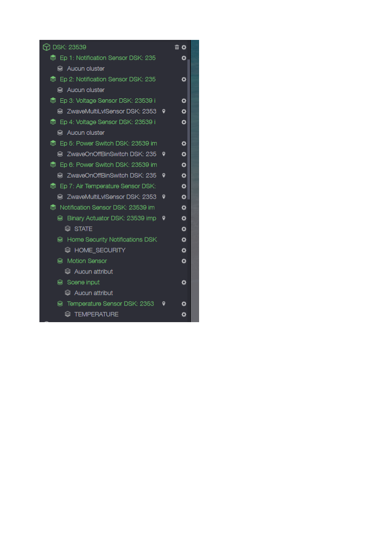

I bought a new Smart Implant device and included in Zipabox but unfortunately it seems not properly supported by Zipato. I still have the same problems with the inputs not showing correct state.
Please Zipato give us some hints to correct set this device that is replacing the old Binary Sensor.

I have eight of these Devices what do you want to do? I use it as Relai, Sensor, and Analog Meter.
Ep3 and Ep4 are for analog Sensors but you get only the volt meter. You have to add a virtuel meter and a rule to convert the results.
Ep5 and Ep6 are to use as Relai so I use it for my lawnmower mit 28V. To start or stop mowing. You also can use it for a Sensor e.g. a Rain sensor.

Hello. I try to use the fibaro implant but it doesn't work. I feel like it's not well included (PJ). Thank you for your help.
zipato V2 or V3? Since V3, Zipato has had big problems with this device. I have already opened a ticket and am waiting for a solution.
Hello. Thank you for your reply. I use the V3, so we'll have to wait.
