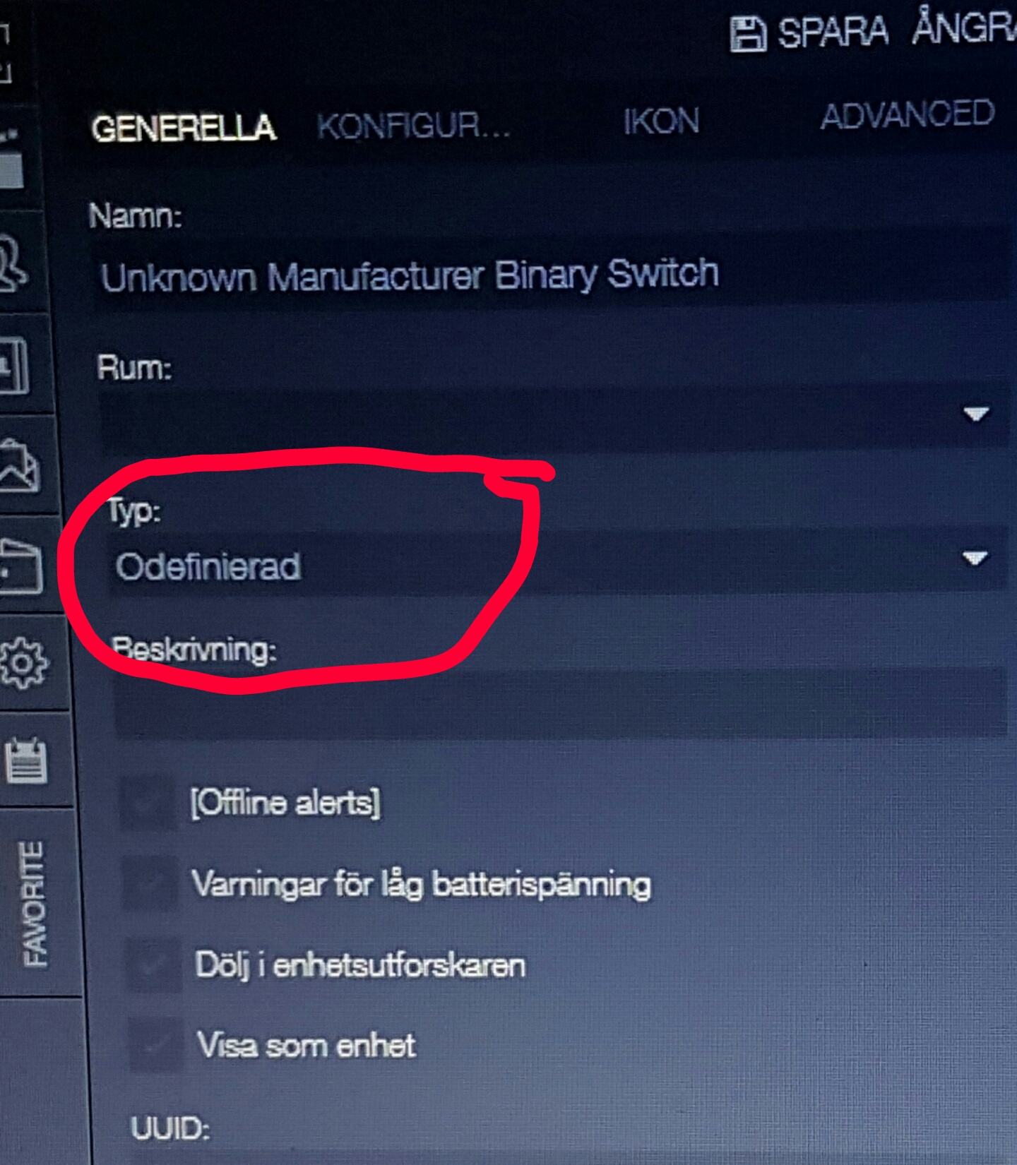

I have tried to add a Telldus Plug in switch (z-wave plus) and zipabox find it and i can control it but why odefinierad, and it wont chance. I have tried to remove the plug in and add it again, several times but the results are the same. Why?

It's because the device is brand new and doesn't have the relevant entries in the master database quite yet. Simply change the device type manually to plugin and you'll be all set. It works flawlessly.

Yes I bought this at kjell.com at 299SEK. I have tried to change it manually but there is nothing to change to. 5f5cda2015bc260eed67448b433bd367
In the general tab, you can freely edit the device name, description, room, and device type.
If you open the list, you can (or you should..) choose the right device type.
if you can't, try to open a ticket at support.zipato.com

I just came home with the Telldus Smart Wall Plug Z-wave and included it easily - then I experience the same issues as above with Jimmy's image with regards to changing the type in the second level "Group 2: On/Off control". Since I can't change the TYPE of DEVICE I can't see it or the switch. I can see the "Telldus Smart Wall Plug Z-wave" as a device if I check that in the first level and there I can also freely change the type of device but then I just get an eunuck device without the switch.
