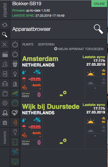

Weather station did work yesterday evening. This morning it didn't. I did install 3 weatherstations, all are without actuals. So the problem is still there.
I have two defined. One has full details, and one only part details, although the Sunrise/Sunset for both are showing and these are what I use within my rules. Both are synching and have been since the fix went in.

http://zupimages.net/viewer.php?id=19/11/2bbz.jpg

As a very critical user I can see that it seems to be a mess. But it isn't. WU (weatherstation) is NOT a Zipato problem, but also via IFTTT and other media.

Everything is fine now with FW 1.3.60. Weather seems to work now. Sunset/sunrise is o.k. But there is no precipitation.
BTW: I have sunset/sunrise backup from IfTTT but I like the Zipato solution much better, because it keeps the time if internet is off.
If my internet is off (Router failure or I do not want my box always connected), Sunset/sunrise time stays with the last sync. I can live with this for a week or so.
What box do you use?
Zipabox 1 FW 1.3.60
However I had to create new virtual weather devices and I deleted the old ones.

Status update: My weather station shows offline now. Sunset and Sunrise rules are still working.
What a mess...
I also do not have a wather station.The sun does not work
I meanwhile updated to 1.3.62 Beta on my Zipabox 1 and still the Virtual Weather is not working.
I deleted the weather station several times and recreated it.On top, I cannot delete the Astro-Values from my Planners. It always jumps back to Sunset and since there is no sunset value, my Roller-shutters are not lowering at all automatically.
This is one of the main usecases for the box for me, and now rendered useless.
