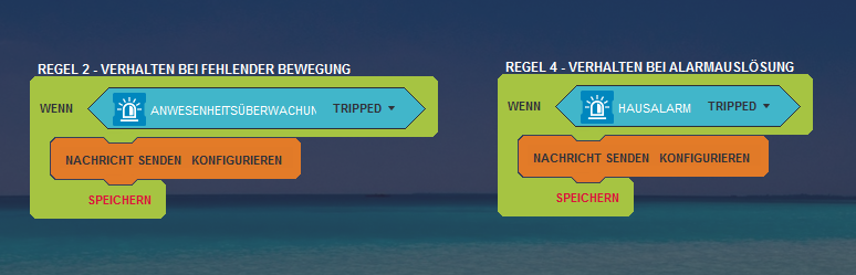

I tried to set up two alarms, one to send me an email if there is movement in the flat and one in health care mode to send me an email when there is no movement for some time.
But once you set an partion to health care, you will no longer be able to use it for triggering other rules. So If you want to do more then sending a predefined message (perhaps one with an adress or additional information in it) or if you want to do anything else (starting a camera, switch on lights) you will have to define your own health care mode and use that instead. (perhaps someone has already a good idea for a counter which easily monitors some sensors and trigger a rule if there is no movement for some time and would like to share his solution?)
Or to put it in a nutshell:
if you activate health care mode, you can´t use the alarm partion for "tripped" or "all".
The good news: If you use health care mode, it now seems to work flawless: No more false alarms and no forgotten alarm. Just keep in mind only to use those predefined messages.
