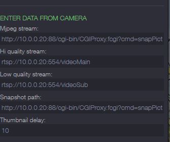

im using a foscam C1 which is working inside Zipato RTSP, MJPEG and Snapshot URL (which is the same as the MJPEG Url).
Im also using a rule which should send an snapshot image every 90 Seconds after triggering an alarm partition - this is working but the snapshots are not from the actual time (sometimes also 10 minutes old (got the timestamp inside the snapshot (which is coming from the cam))
Also the refresh button on the cam is showing an old picture.
Maybe someone got an idea?
