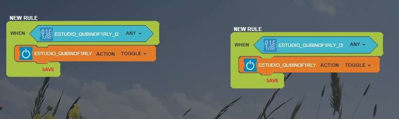

I assume when you included these switches you should have a "Touch control" device or maybe a "ON/OFF" device. If you have two switches to control 1 bulb and the switches are not wired as 2 way, then I asume one of them ("master") handles the load and the other does not have anything connected to the load, is that correct? If this is true you could create a couple rules that detect any change of state in the buttons and toggle the load of the switch with every press, see attached.
Unfortunately I have tried this, but its not worked because of the Switches switched on-off continuously.

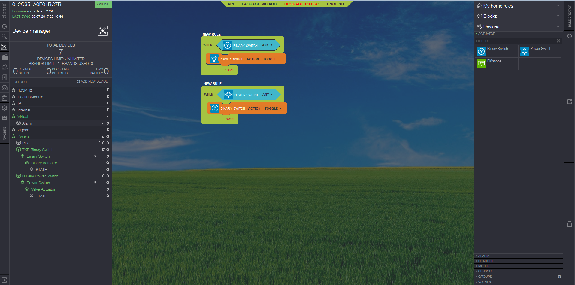

Andras,
I think that could be because you are using the Output (relay) in your rules, can you post a picture of the device with all the endpoints? maybe it doesn't have touch/input endpoints and only relay/output. That would explain why the rule makes the bulb switch continuosly.

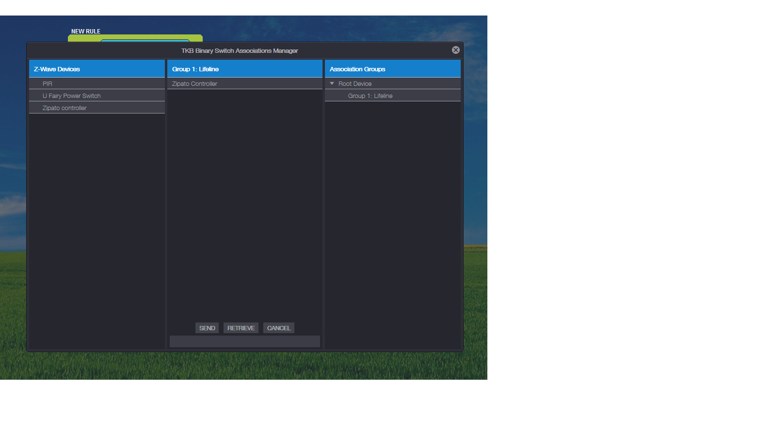

Dear Alberto
I tried to set it up association, but i cant find in Groups the On/Off section. Can i somehow set it up?

Hi Andras,
In the assotiation window on the top it states TKB binary switch. It should be MCO, so it seems a different product.
I know for a fact that MCO has this feature but it seems you have selected the wrong product so you see incorect assotiations
