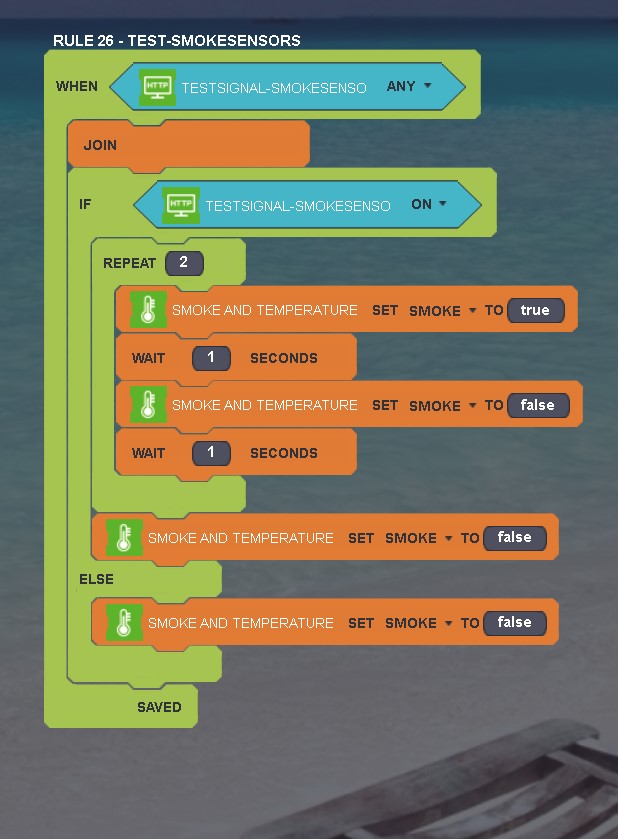

I have mounted my first fibaro smoke sensor on the ceiling in one of the rooms. The sensor can be tested by pushing the center button 30 seconds, and then the sensor should give a couple of loud beeps. So far so good.
But the sensor is on the ceiling, and I would like to perform a test from a rule, eg with a virtual switch. This way I can avoid using a chair or a houshold stepladder to test the device.
I tried to make a rule, as attached, but that doesn's work. Any suggestions ?
Replies (1)
please try a simp,le rule without the Jojn puzzle - why you need the Join puzzle?
Hi the join I don't really need for the test. But normally without the join, when you activate the virtual switch and the previous loop is not yet ended, they interfere. But using or not using join won't make a difference for the test, I think, I will give it a try. Thanks for the reply.
