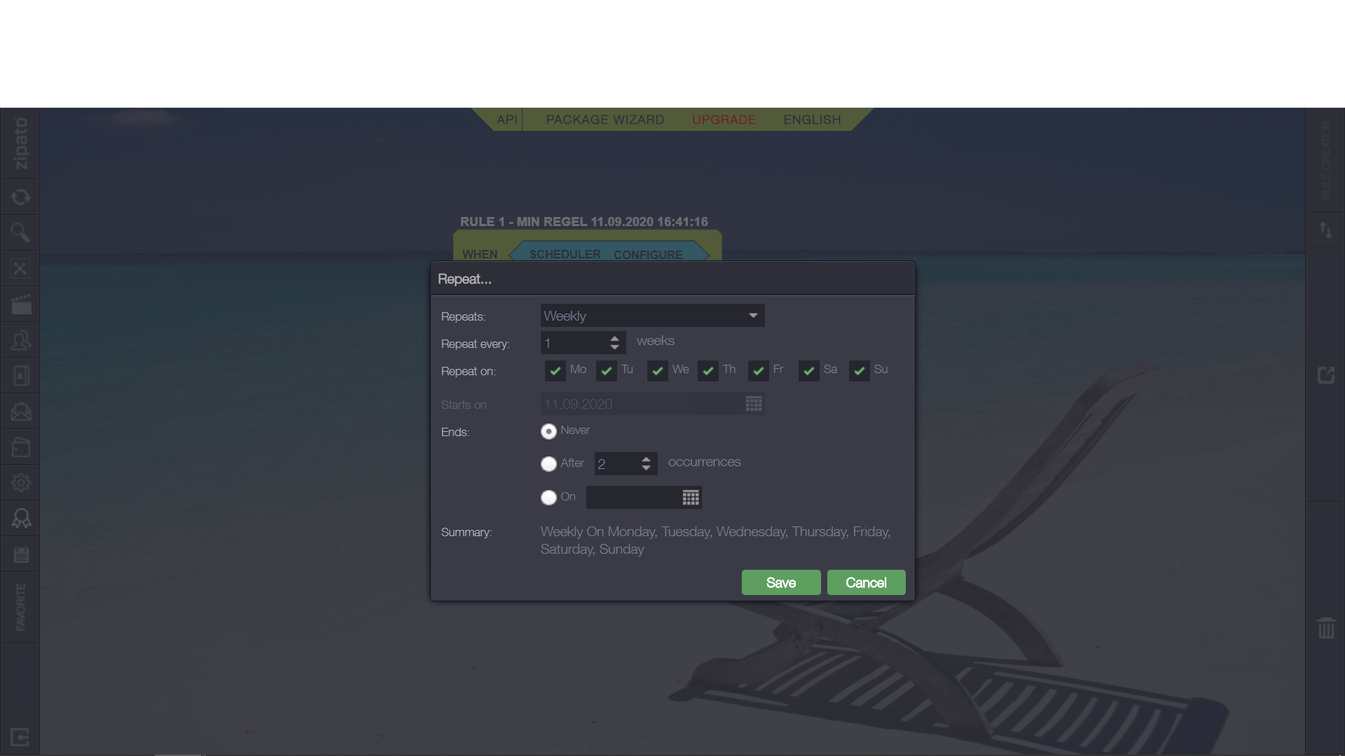

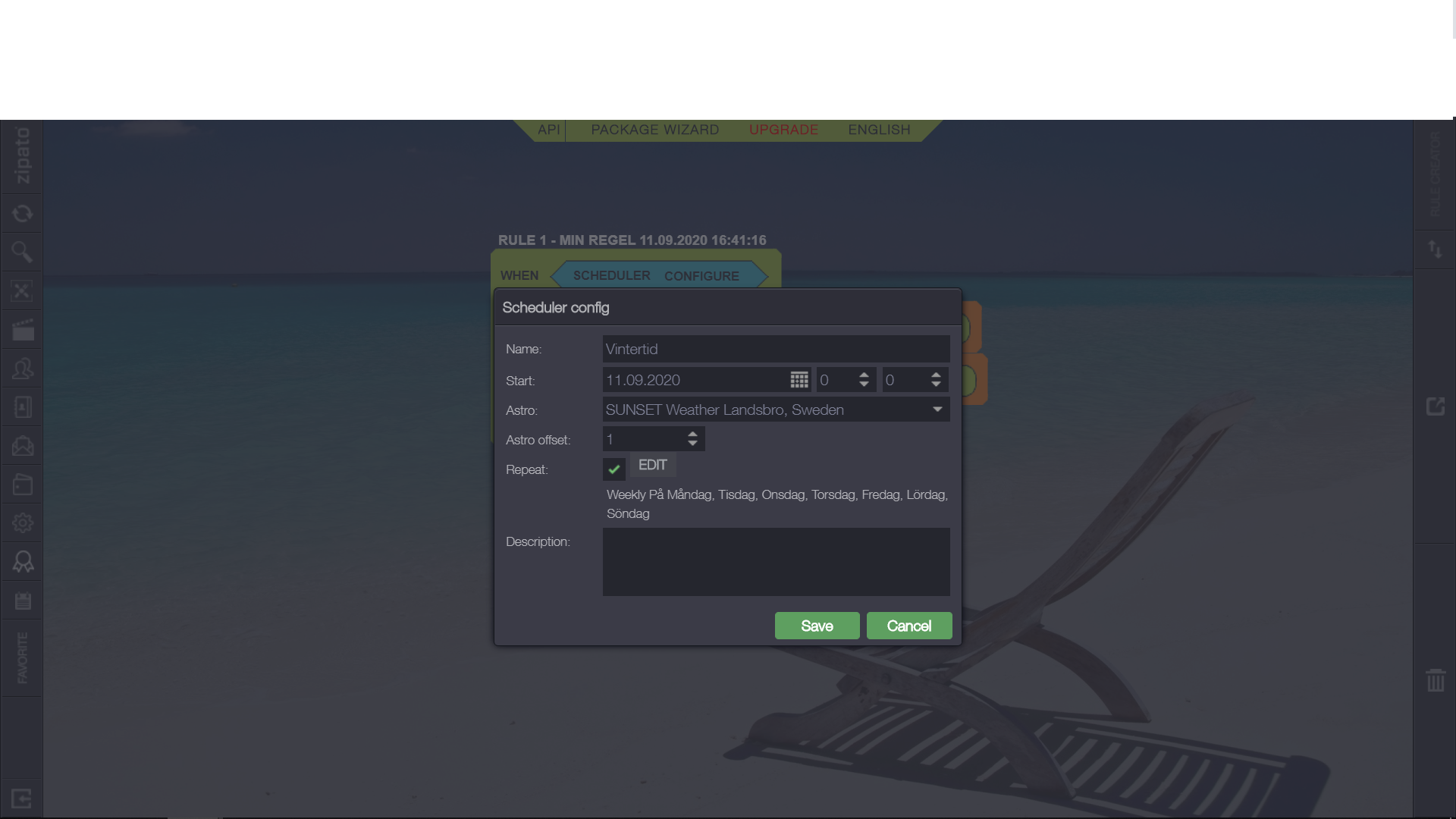

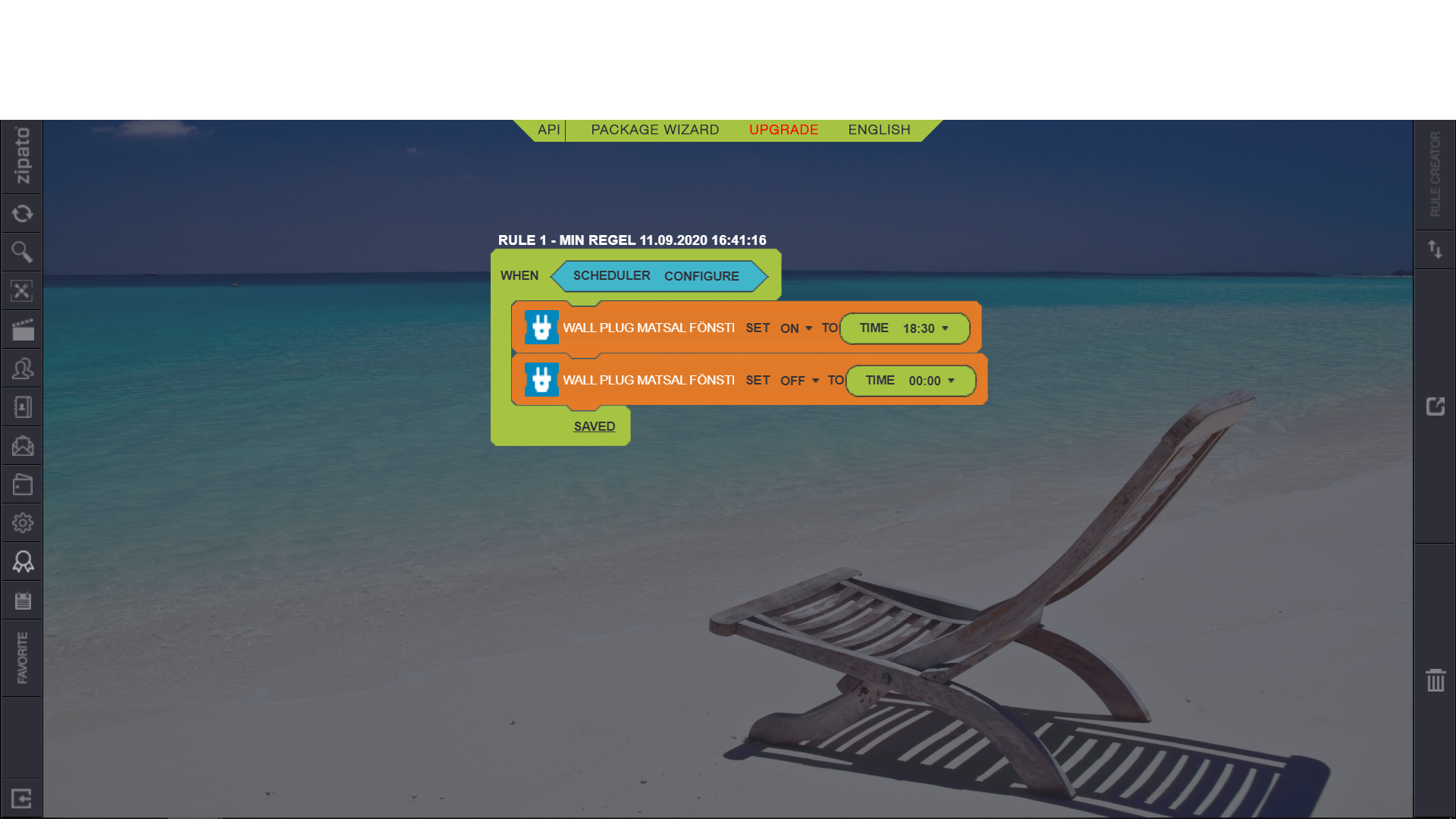

Is completely new to this. It seems very simple but does not make my schedule work. Can anyone help me understand and do the right thing? See pictures!

The "When" triggers the rule, i.e. you will only trigger this rule 1 hour after Sunset every day.
I recommend you to create one rule for each "activity", i.e. one rule to turn on the lights and another one to turn the lights off. I think it is a lot easier in that way. I know in the beginning, I was also trying to do "everything" in one rule but those rules tends to be difficult to maintain on future updates. The below rules is two examples that I'm using and not quite as you need them

Hello Dan! Thanks for the input, so I split "on" and "off" in each rule. But it did not help a bit. Nothing happens! Something I do wrong but the question is just what .........?
Do I understand your intention correct? And am I right that the wall plug is turning on some lights?
You wanna turn on the wall plug at 18:30 and shut it off 1 hour after sunset but latest 00:00?
Yes
When I read my previous post to understand what you wanna do I can now see it's a bit confusing and with you answering I was assuming your intention correctly it is even more confusing. Please write with your own words how you would like to control your wall plug and I will try to help you.

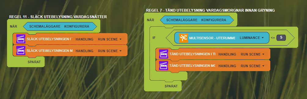

Oj, det var ju inte så krångligt. Då gör du såhär:
/fdc7125043067fb8d6efbc9857281e9b

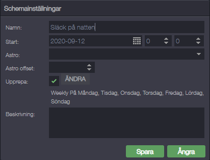

Där schemaläggaren till vänster är konfigurerad som följer:
/b27c6812a759424505708baa9ed7ef24

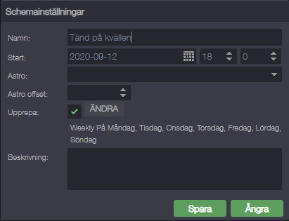

och schemläggaren till höger enl. nedan:
/9500ba4b25c7d875fbeba5070477fe3c
