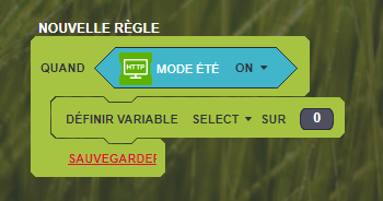

you must first create a variable and define it (replace "select" by creating your variable and activate the switch to set the variable to 0 :

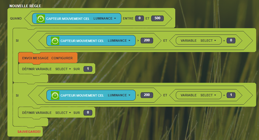

Then create the rule (Replace "select" by your created variable) :

Indeed Dino's solution is better. In the rule, the variable must be replaced by the virtual switch.
