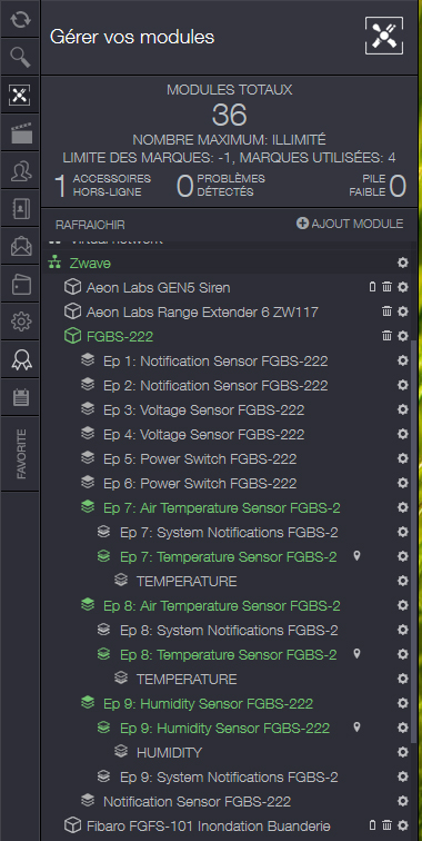

I am trying to connect 2 temperature sensors DS18B20 on an FGBS-222. I have the impression that the 2 sensors are well taken into account by the zipabox.
The internal temperature of the case rises via EP7
The 1m sensor on EP8 and this is considered a temperature sensor
The 3 m sensor on EP9 but in the zipabox the temperature probe is considered as a humidity sensor. When I take the sensor in my hand the humidity increases! A way should be found to change the type of HUMIDITY probe to TEMPERATURE sensor in the zipabox at the zwave module.
Is it possible? Thank you
Cordially

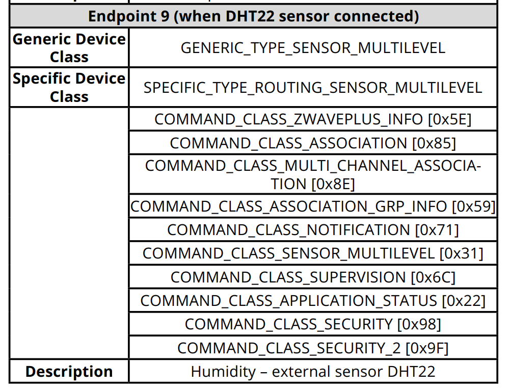

I owuold lik eto infrom you that its descriptor is created according to FGBS-22 manual if DHT22 sensir is connected - Endpoint 9 is assigned to Humidity - see fig. Unfortunately it is not possible to implement all possible cases enabeld by FGBS-222 into its descriptor, so the only option is to manually change icon and type after inclusion of this Enpoint 9 if necessary.
