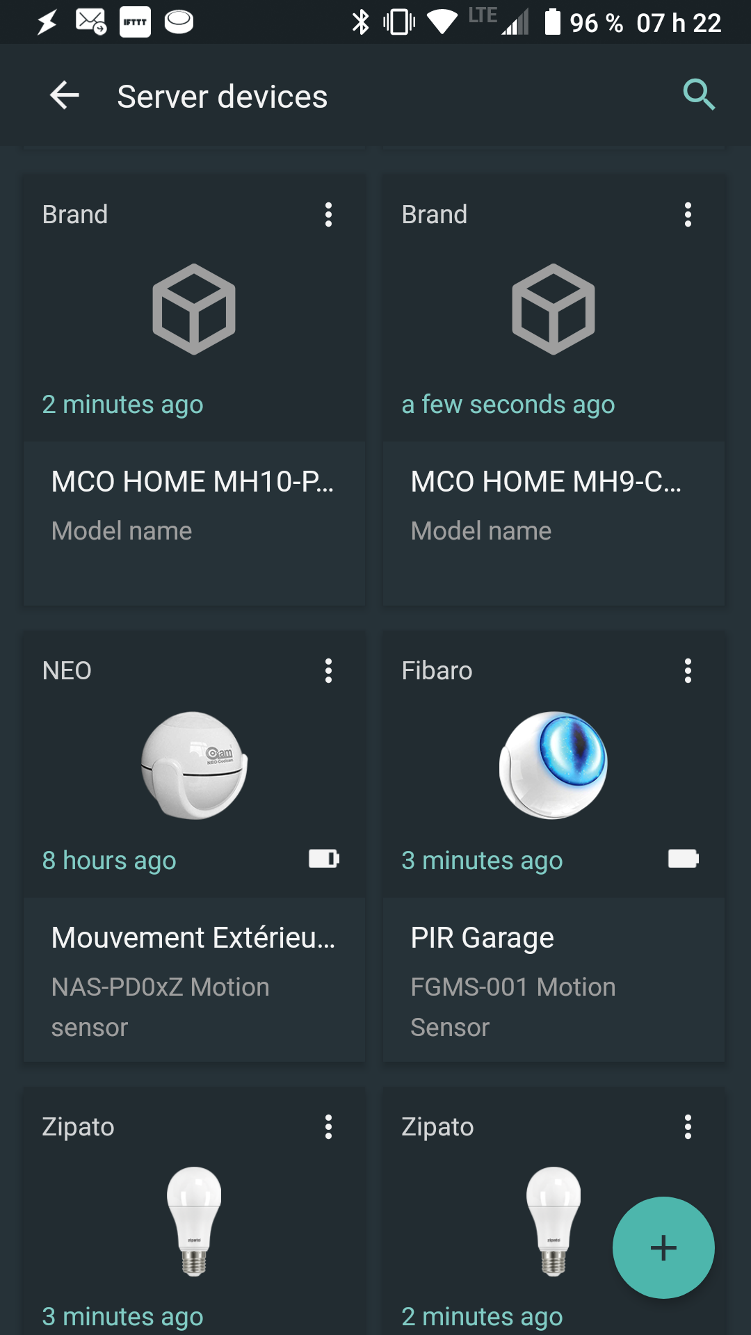

Devices I had in v2 work in v3 also, but work fully only when using them from my3.zipato.com.
In new v3 app unable to add devices to rooms, lacking control etc.
