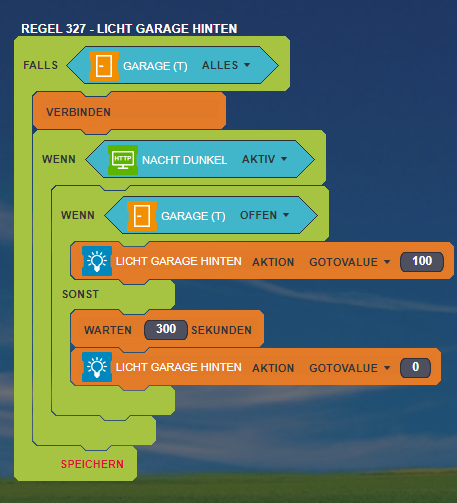

Hi Tomu
Actually, it'ss a very simple rule. Here is an example:
Hi Tomu
