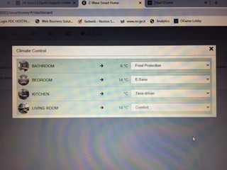

question: if I install a zipabox2 complete with software bundle to control 9 thermostatic valves
Aeotec Radiator Thermostatfor radiators and control them with smart thermostat pro, I have to purchase 1 software bundle plus 8 smart thermostat pro software
if there is another solution you can know which one

good morning Dino
is this valve (Aeotec radiator thermostat) considered a physical thermostat?
thanks

ok funziona anche il termostato di zona pensavo che servisse sempre il termostato pro ho speso molti soldi quando non serviva :-)
ok the zone thermostat also works I thought the pro thermostat was always needed I spent a lot of money when it wasn't needed :-)
