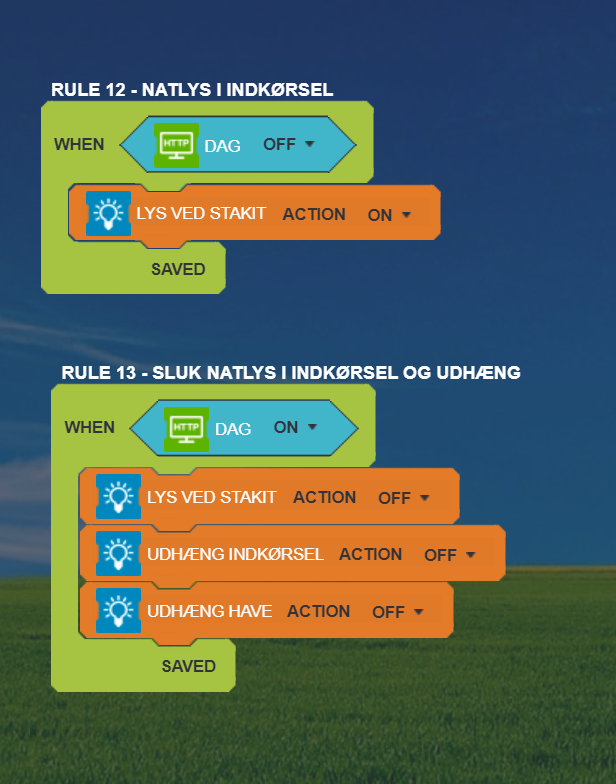

Pic 2: Sunset rule (Natlys)
29b171e3aca5800f40e07624384b5d81

It all works now, seems the light switch just needed activation from a virtual switch instead directly from the virtual weather station. Im not that familiar with virtual switches but will look into them for future rules.

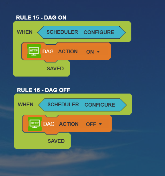

Can you please show a screenshot that shows how to solve this with a virtual switch? I have the same problem and don't know how to use a virtual switch in that rule.
Hi Phil

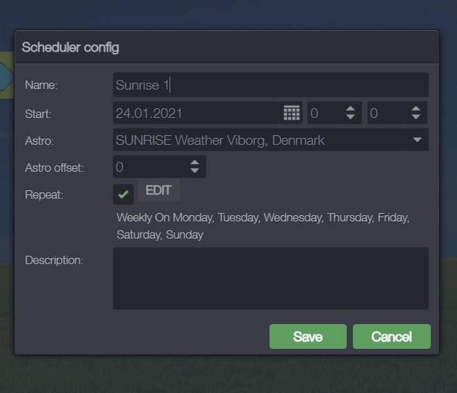

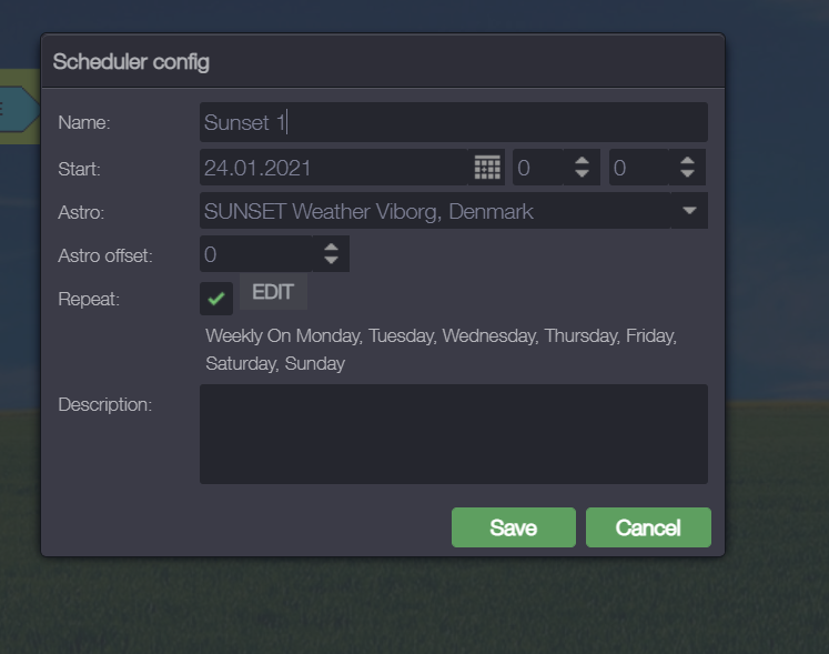

Sorry for the late feedback.
Here are screenshots regarding the subject:
