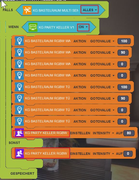

i created a virtuall switch to control more then 1 functions.
i created a scene and set this vswitch to on (it works).
in rule generator i created a rule see pic attached and it doesnt work, but is a really clear config.
i puted 2 rgbw controllers in 1 group and set intensity of it.
A Bug again or what is wrong?
2021-03-02 15_1...
OK everything works except that the groups are not set to 80 or 0, correct?
i testet without groups too but nothing is working. Also some older rules created on Z1 are working but cant be deleted or changed, maybe thats a conflict. Also i tried some other rules with vswitch but no success

Please try to insert a waiting element above the last part of 1 or 2 seconds.
PS: I also speak german.
