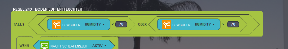

Hello, could you help me out to get why my rule doesn't work?
The idea is to trigger bath ventilator via humidity sensor
Files: 1.PNG

Попробуй такой вариант)

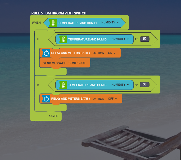

Your Problem is the header, please try this (oder = or), instead of 70 you have to use 50:
