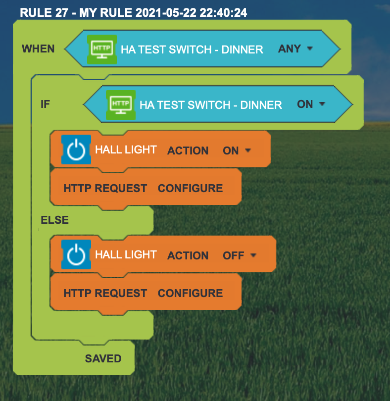

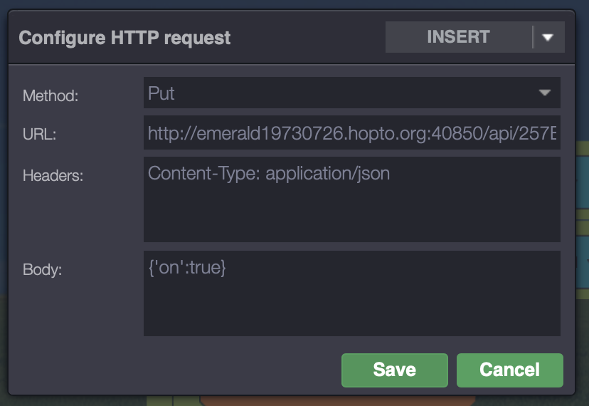

Lets look at my rule!
URL: http://emerald19730726.hopto.org:40850/api/XXXXXXXXXX/lights/2/state
HEADERS: Content-Type: application/json
BODY: {'on':true}
This is my HTTP request and rule.
Any ideas?

Doesn't it work?
Doesn't work....
Have you tried using something like the MuleSoft Advanced REST client to test the request?
I tried in Postman: it was working.
But the cURL calling is right.
Grrr.....
I tried from 3 external servers: it works.
Sometimes it works from the Zipato server, sometimes it doesn’t. (1/10)
The Zipato server is unreliable?
