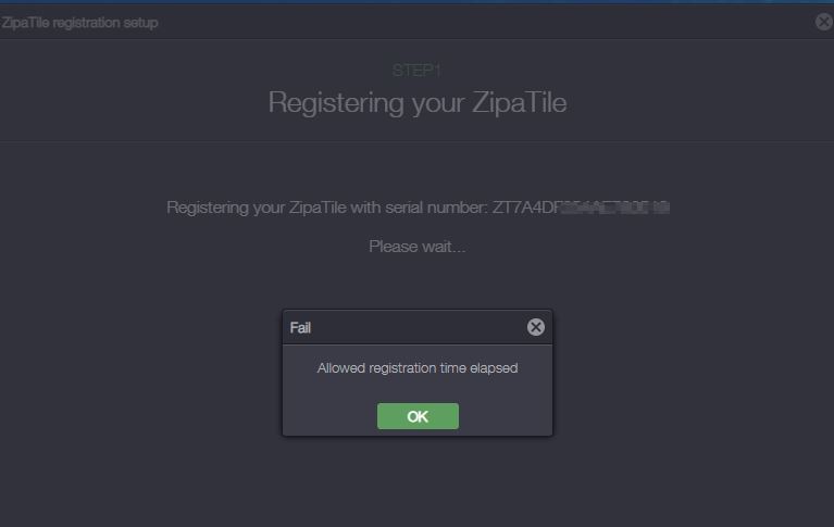

i tried this to fix my Zipatile and does not work. I cant even register my zipatile anymore. allowed registration time has elapsed warning . first time I see that. so I am totally locked out it seems. Please help or suggest a solution.
