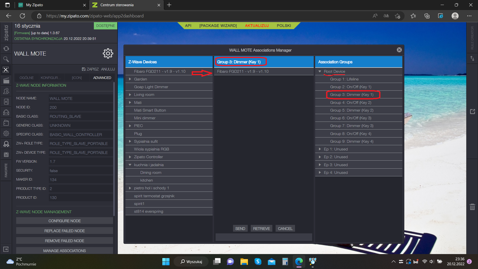

You can associate each dimmer to the particular button. Short press -toggle. Slide -dimm.

Roberto,
it works for me. I tested with Qubino mini dimmer and Fibaro dimmer.
Please do remember that you need to add dimmer to the group3 (dimmer key1), click SEND, wake up Wall Mote Quad (receive confirmation that assosiation is set) and then click retrive and wake up Wall Mote again. Afterwards add the second dimmer to the group 5 ( dimmer key 2) and follow the procedure as before.
Hi Adam,
thanx for your support!
It's working!
