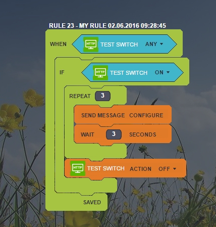

1) A conditional wait causes subsequent commands not to be executed.
This is quite subtle. If you place a wait inside an "if" block, the commands that come *after* the "if" block are not executed, but this only happens the first time after rules are synchronised. And not even all the time - perhaps in 90% of cases.
So if you have:
if (x) blah blah; wait 20; blah blah
xyz
After you create the rule and synchronise, the first time the rule runs, "xyz" will not get executed. This has been reproduced by Zipato.
This can obviously cause mysterious, apparently inexplicable failures.
(It may also occur the first time the rule is run after rebooting. I haven't tested that).

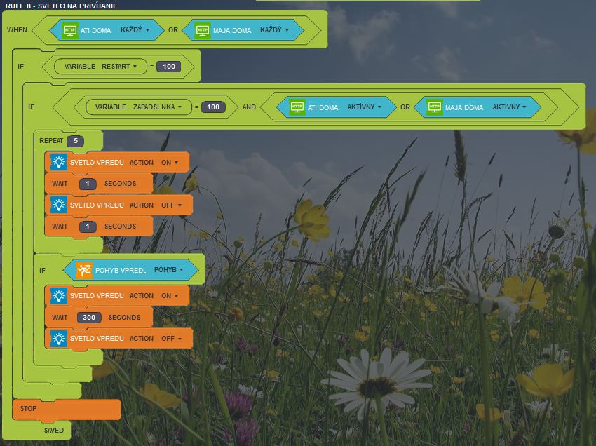

I would add the fact that if you use a JOIN and a REPEAT block in the same rule the repeat does not work. This is a known issue too.
Alberto, for me the repeat does not work regardless if there is a join or not. This rule basically should flash the outside lights 4 times when I (or my partner) get home and the presence detector changes state to on. It only flashes once.

I had issues in a rule and tried to solve it by adding a wait in it. Bad idea it seems...
Thanks David
Yes, if the "wait" is inside an "if". Hopefully this will be fixed soon. It explained a few mysterious rule failures of mine.
Just to let everyone know: bugs 1) (conditional wait) and 3) (date comparison after midday) are now fixed.
Also, the repeat now works for a while.
