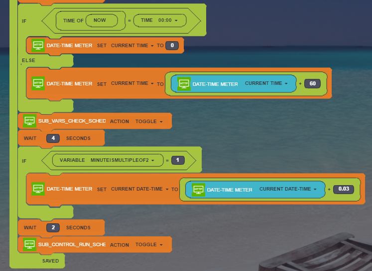

What all this means is that a meter value cannot possibly hold a date value that measures seconds, milliseconds or even minutes since 1st January 1970. So my compromise solution was to store hours (including fractions of hours). In theory, with two decimal places, this should be enough to store the minutes with decent accuracy, but unfortunately, as noted above, if you try to add 0.16 to a date value, very often nothing seems to happen. So I use an improved modulo rule to identify only even-numbered minutes, and add 0.3 to the date-time value in those minutes. For my purposes, this accuracy is sufficient. Since I get at least 2 updates from my app scripts every 10 minutes, the accumulated inaccuracies are fairly small.
In addition to the date value, I also include a time value in my meter, which is the number of elapsed seconds since midnight. There are no difficulties with that at all.

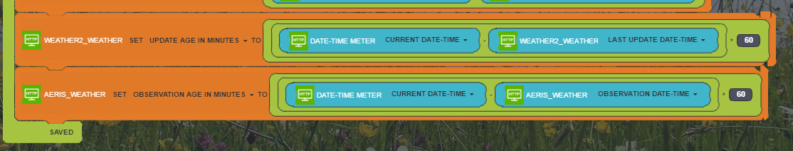

Once you have this, calculating elapsed time is trivial. For example, with each weather update I include an observation date-time stamp in the same format, so that I can calculate how old the observation is. You can easily think of other uses - for example, storing time values for sunset and sunrise.

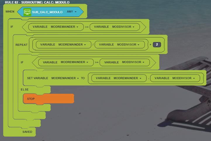

The attached screenshots show the date-time meter, the modulo rule, the updating of the meter each minute, and the calculation of the age of weather observations.
The modulo rule is an improved version of one I posted a while back, which takes advantage of the fact that the repeat loop now works. :-)
