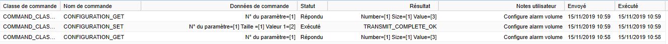

I'm trying to use the AB02z siren with a Zwave controller.
Unfortunately none of the config set commands seems to have an effect ; for instance
if i send config get param 1, the answer is 3
Then I send config set param 1 value 2 ; i get an msge saying command has been executed
If then I send config get param 1 , the answer is still 3, value unchanged !
Any idea for overcoming this problem is welcome
Rdgs
FG
when you Send config parameter, you should wait for the confirmation from the device (sometimes is necessary to wake up device). After that by Retrieve button you should receive the new value of the configuration parameter.
