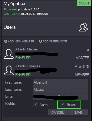

Wanted to know if there was a way to create a guest user. I would be the master but for my kids for example i dont want them changing all the settings, i just want them to be able to control the system. Thats it!
Is there a way?
Liam,
Yes there is, you have to set the user as "tenant", save and sync, see attached.

You don't need to assign the devices to the account. This account will only prevent them to add, delete, edit devices. If you give the user alarm privileges they will be able to arm/disarm the alarm.
Regarding your question from your other topic, they have to sign in with the "tenant" user and passcode you have configured. If you want your Zipatile to run with this account you have to logoff from the master and then login with the tenant.
