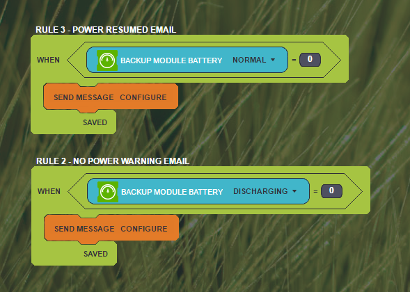

Hi Robert. I have to rules that give me a message when the box resets. They use the backup power expansion module. The messages are sent when the box comes back online. Don't me why, but they just work. I guess the box briefly goes onto backup power on a reset and this is stored until the box comes back online and is sent. It will not work if you just loose internet connection, but will if the box resets.
With this you can them try other things as you suggest.
