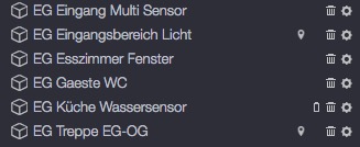

Yellow dot means that the controller hasn't received the "wake up" message from the device in the time specified, still not considered offline. Try to make a network heal after you have installed the sensors in their final location, make sure you wake up manually the device when non-repeater nodes are being scanned. You can do it from device manager >> Gearbox icon on Z-wave network >> Network heal.

I have different sensors with battery. But for a few days I don't have a battery level for the aeotec windows sensor and the aeotec multisensor (see picture). And both are new....
