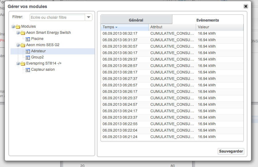

I bought a Aeon Labs G2 micro module a few weeks ago, and I only manage to retrieve the cumulated consumption out of it. I know the module is able to send the current Watts consumption.

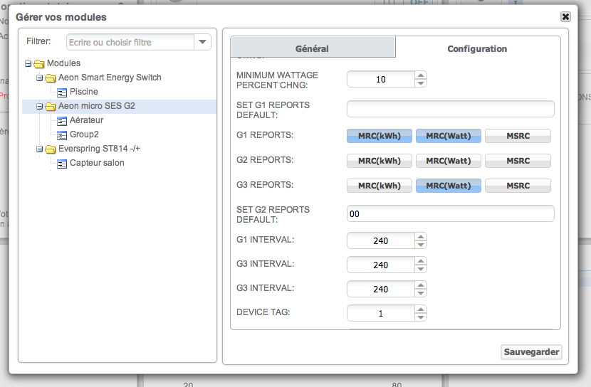

- Is this normal I can select more than one entry in a same G1, G2, G3 reports line of the Configuration tab (for eg. I can select both MRC(kWh) and MRC(Watts) at a same time for G1 report)?
- In the same time, why do we have "G1 interval" and two "G3 interval" without any "G2 interval" (see provided screenshots)?

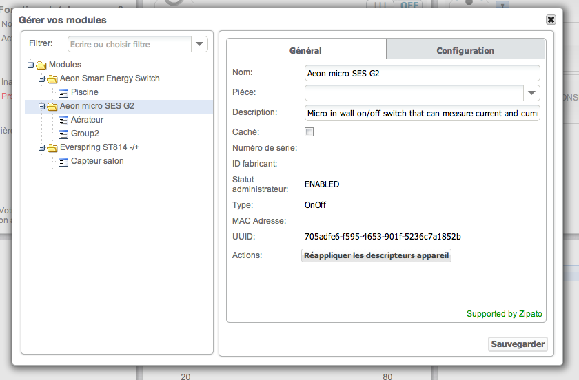

- Why is there a "Group2" under the module in the Configuration tool?
