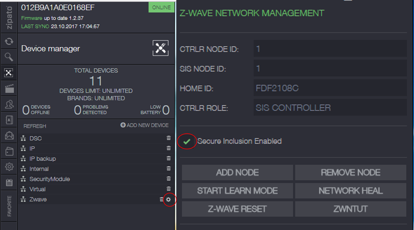

Via normal way of adding devices? I added via add node and says node already exists, but does not show as device. No way to get the dimmer visible. And same error message appears whenever I try adding any other way

SECURITY_COMMANDS_SUPPORTED_REPORT implies that specific device does not support secure inclusion (which means encryption), uncheck the secure inclusion and try again using add device function. Add node includes the device without supported descriptor / template and it should be visible inside device manager, where you can adjust visibility.
If you still have same issue, please open ticket at support@zipato.com including serial number of Zipatile.
