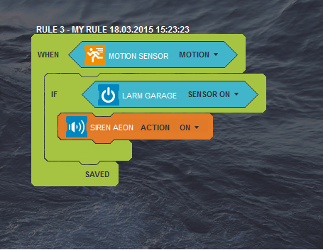

I have an Aeon Labs Sirene Gen5, Fibaro Motion detector and a virtual switch.
Sirene works fine if i trigg it from app or pc. Fibaro detects motion and i can see it on dashboard.
So i have a simple rule (see file nr1) - when there is a motion, if the switch is on sirene have to sound.
But it doesnt. I can see in dashboard that the siren goes high, but there is no sound (see file nr 2).

I did and im sure the rule working that way -
when motion detected Sirene goes high but there is no sound - just like on larm2 screenshot.
When i turn on/off sirene from app it works (sounds). The rule worked with sound only the first time after i create it.
Then i turned off sirene waited for No Motion from fibaro and activated fibaro again. I get Motion and Sirene went high but w/o sound....

I think i figured out it.
My rule is:
When switch X on
Siren = on
Wait 20 sec
Siren = off
So it works every time when i wait 20 sec and restart the rule.
The weird thing is that when i force siren OFF from app it doesnt sound next time i start the rule.
Seems like bug but i dont know is it in my box or its the siren.
Conclusion is "Do not force turn OFF the siren" :)
