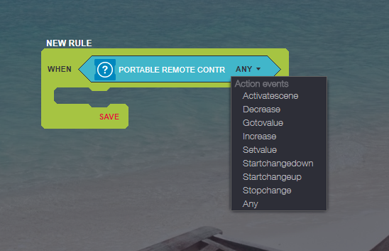

I have a Aeotec Minimote with the latest firmware. Its paired fine with the Zipato box and shows as a Zwave device. I can see the device when creating rules but the actions don't correspond to the buttons.
What do you do now? Do i have to set the device to a certain type? or configure it in a certain way?
Screenshot attached.

My rule creator has many more options:
3febb02f8ff8089c9cb35c6b71aac934
Those descriptions do not seem to reflect what is really happening with the buttons. Here is what I believe the settings are:
1.scene = Button 1 push
2.scene = Button 1 held
3.scene = Button 2 push
4.scene = Button 2 held
5.scene = Button 3 push
6.scene = Button 3 held
7.scene = Button 4 push
8.scene = Button 4 held
not sure what the rest of the scenes are for.
I am also not sure how to get a double press or triple press to work.
