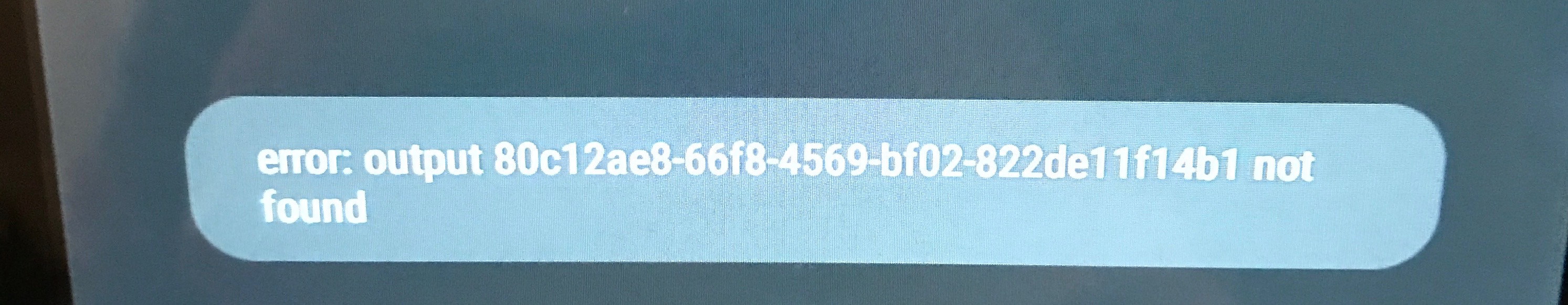

After Reset, new Setup, no possibility to skip or put a phone number
Andy shared this problem 8 years ago
Unfortunately I have tried updating the firmware in the meantime
and much worse probably made a mistake, which is why I called the Zipatile
had to reset.
Now I have to perform the setup again and I am entering my phone number, this can not be entered and confirm, no matter how I enter.
If I skip the entry, I get the message that the setup has not been completed.
What can I do now?
I can not register now under my.zipato.com, there I also get the information that the setup is not complete.
I hope for quick help and feedback, because currently nothing can be switched and regulated.
Thanks in advance.
