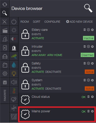

Hi All,
I am new to Zipato. My system currently has
1. Zipatile
2. 2 x Fibaro Dimmers
3. 1 x Flood Sensor (Fibaro)
4. 1 x Wall Plug (Fibaro)
All this is working as i want it. I have not yet started playing with rules or alarm functions etc, but last night at 1pm.I got this email:-
Message: tripped
Partition: System
Armed: HOME
Tripped: true
TripType: MAINS_FAULT
Zone: Mains power
Zone UUID: 61ba9af8-6d7a-418a-922c-1a66dd912967
Endpoint: Mains Power State
Attribute: STATE
State: MAINS_FAULT
And an automated call at 1am asking me to press 1 to acknowledge!
I tried to find the the device with the UUID but i dont have one. As i said i have not set any alarm functions & from what i can see i have set all the alarm functions at the default setting which is the maintenance setting. And the important thing here is nothing has tripped! What am i missing here? Be grateful if any one can help me on this. Thanks

Hi Vimal,
"Mains power" is a zone inside System partition, and each time you disconnect the power supply from your ZipaTile this partition will be tripped and you will receive an email and a phone call.
This partition, together with Safety, Elderly Care and Intruder partitions, is created in the wizard which starts after you register the ZipaTile. Safety and System partitions are armed by default, while Elderly Care and Intruder partitions you need to arm manually.
Besides "Mains power", System partition includes "Cloud status" zone, which will trip the partition when ZipaTile loses connection with the cloud (look at the image attached).
There are two ways of avoiding scenario of receiving calls and emails when power supply is OFF:
1. Delete the "Mains power" zone (not so good solution)
2. Deactivate System partition (this is better solution, but in this case you also won't receive notification when you lose internet connection)
Enjoy using your ZipaTile!
Branislav
