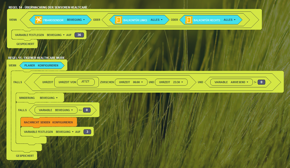

Own Healthcare:
I wasn´t quite satisfied with the original healhcare mode, manly for three reasons:
- I can´t trigger anything else with it ("if healthcare=tripped" doesn´t work in my rules)
- The system email is quite cryptic
- when I stop it for the night and start it again in the morning the time count starts again, even if there was only one minute missing for the alarm to ring.
So my rule gives me more flexibilty. Every action sets "Bewegung" to 36 and every five minutes I decrease it by one. If it reaches zero (after 3 hours without movement), I get my customized mail.
"Anwesend" is the switch to start and stopp the healthcaremode when on holiday.

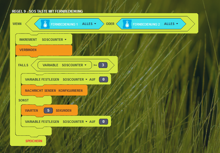

Rule SOS is my emergency rule with two remote controls, normally used for switching lights on and off. If one button of one remote is pressed three times in fast succession I get an emergency mail.
Both rules together help me to monitor my mothers well-being.
Own Healthcare:
