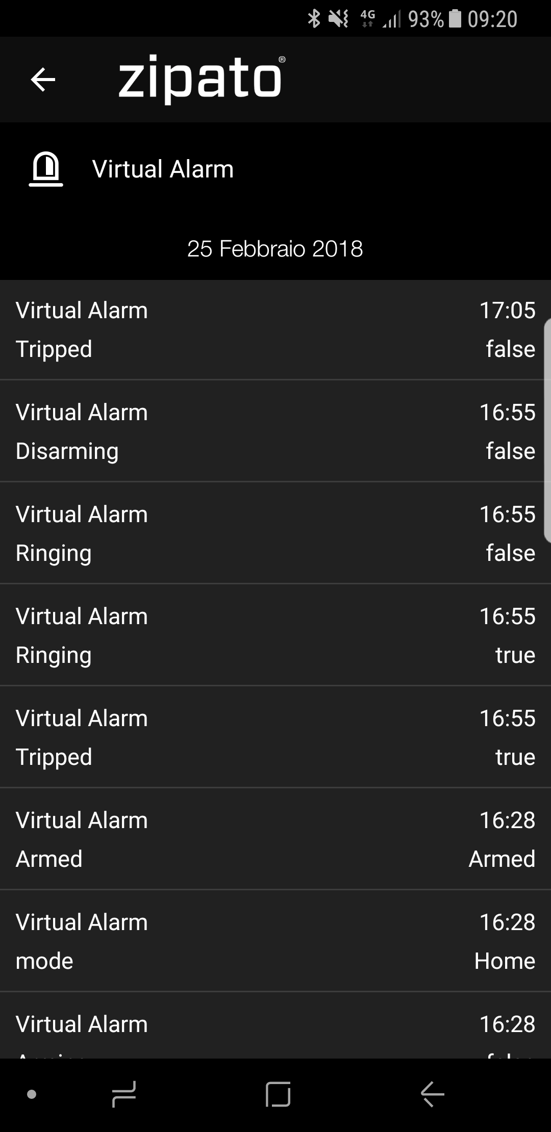

Yesterday, at 16:55 I had a perimeter breach while Alarm was armed but unfortunately the siren started and stopped in less than a minute leaving the house completely unprotected and not warning anyone in the neighborhood about the thieves.
Looking at events log was the zipabox itself that stopped the siren (see the "ringing" true/false at 16:55 in the screenshot) after the tripped event.

My alarm configuration is in place from July 2017, with "siren time" set to 0 (that was supposed to mean unlimited siren).
I tested the configuration multiple times in the past and it always worked (siren starts and never stop till manual reset).
Yesterday, with a true breach, it didn't work.
If this configuration parameter has changed its behavior (maybe due to a firmware upgrade?) I'd have preferred to know in advance (i.e. release notes?) to correctly change the configuration instead of leaving the house unprotected...
