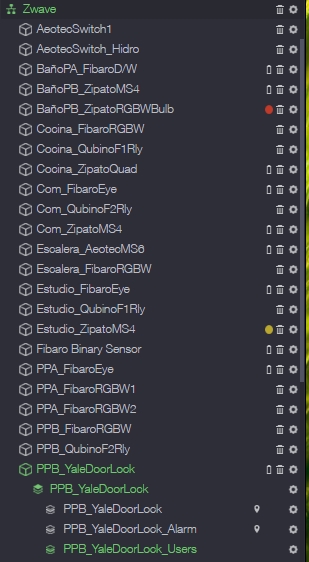

I have two Yale door locks succesfully included to Zipato using Zwave modules, as far as I know only Yale Real living family is able to work through z-wave and zigbee. I actually use this to arm/disarm the system, according to yale documentation, any of their locks with this module can handle up to 250 users but zipato only lets you use 10, I know from Sebastian they are planning on updating this part on zipato side, as well as the ability of scheduling users.
My yale real living have arming/disarming events either while using the keypad or if you turn the know to lock unlock. Also have a lock similar to doorman lock (previous version) this one however is on purpose "Offline", I guess at the beginning I was worried Zipato interface wouldn't be safe and also because there is no biometric door lock zwave or zigbee enabled that I could find. This lock has also the slot for the remote control module, which is the same as the zwave module slot but unfortunatelly it does not work with the zwave module (already tried).
