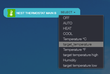

Am I missing some Nest attributes?
I have seen mentioned in the forum that Nest thermostats should display:
- The target temperature
- The thermostat mode
- Nest presence detection
Yet I only have the current temperature and humidity as visible attributes in the Device Browser (in rules, I can see all of the attributes). See screenshot.
Is this correct?
To clarify, when I say "the Nest thermostat", I refer to the device with the thermometer symbol, which is what I use to control the set point.
OK, the guide Vedran just posted clarified a few things. You need to find the setpoint devices in the Nest thermostat hierarchy in Device Manager, rename them for clarity, and then make them visible in the Device Browser. Then you will see the setpoints as separate devices in the temperature category.
