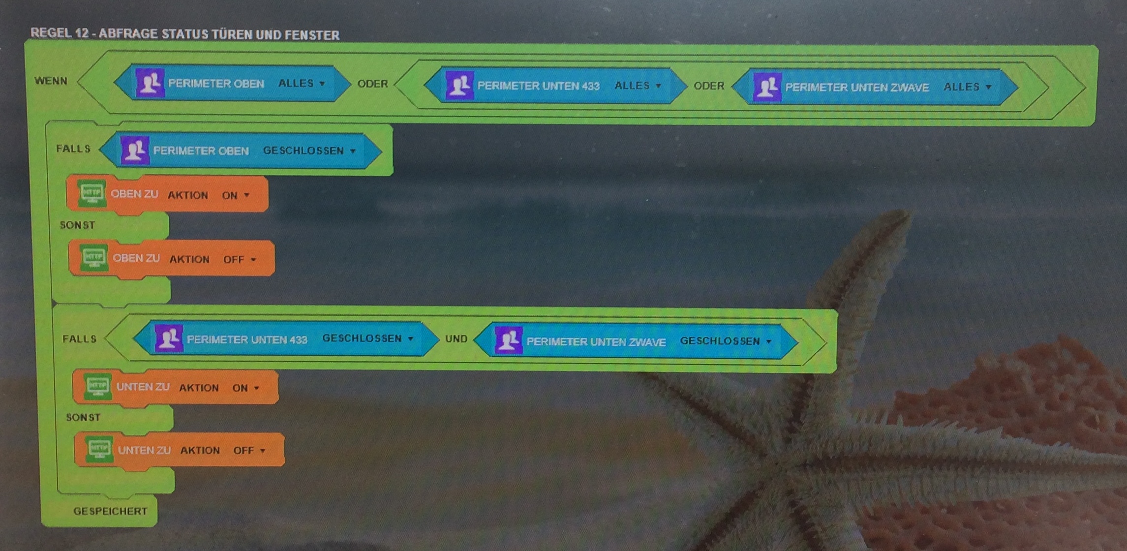

I am trying to get Groups working in my rules.
I created three Groups consisting of all door and window sensors (each group the same sort of devices). I saved the group.
Now I want to trigger a virtual switch depending on the state of all windows / doors. If all are closed the switch is on, if one ore more are open the switch is off.
The rule looks like:
Where is my fault? Or are Groups not really working in the Cluster
Thanks to all
Bernd

Grouping only works for some actuators. Specifically Zipato RGBW bulbs as far as I know and only to send commands to it. I have a ticket opened since March 26th 2016 because I also wanted to group sensors like you did and it didn't work. The only thing they answered is that is a bug and they are working on it... stil.
