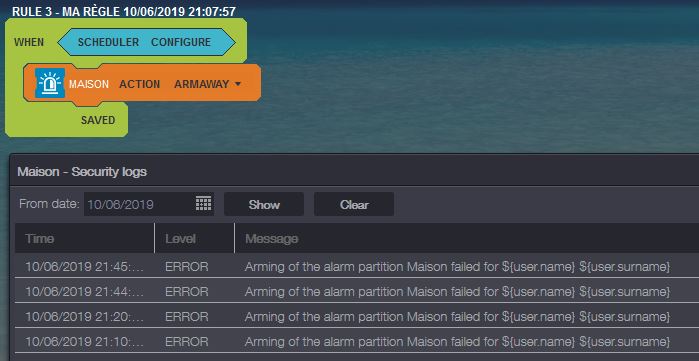

How can i arm the alarm at a specific time ?
I tried with a rule but I have the error "Arming of the alarm partition Maison failed for ${user.name} ${user.surname}"
Is someone have a solution ?
Best Answer
You checked fast arming?
Replies (2)
No, "Quick arm" was not checked and it works much better now.
Thank a lot AP.
