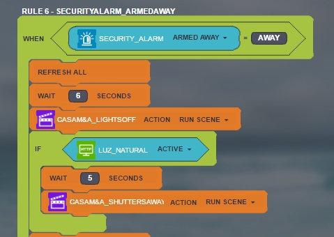

One question, Why are you using the IF ARM event and then ARM AWAY meter, wouldn't be easier to only use IF ARM AWAY meter? I have rules that test also ARM/DISARM conditions straight from the meters and they work fine.
