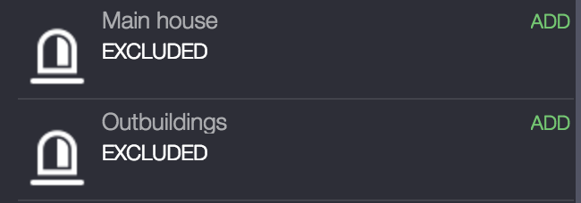

I manually run a 'bedtime' scene to close down lights, etc, however I'd like this to set house alarm to 'Home'. The alarm appears as available in the scene but I don't appear to be able to set it's state. Help please? Thanks

However this is really annoying now. I have just accessed the set up of the scene and I WAS able to see buttons to choose state of the alarm OFF, HOME, AWAY. So I set the two alarms to what I needed. Then I look at the scene again and they are not settable again...? Then I go in and they ARE visible again!
