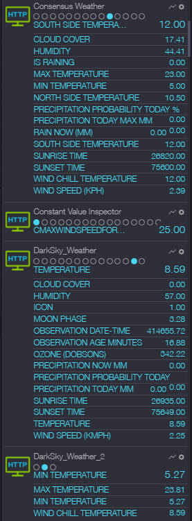

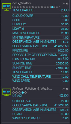

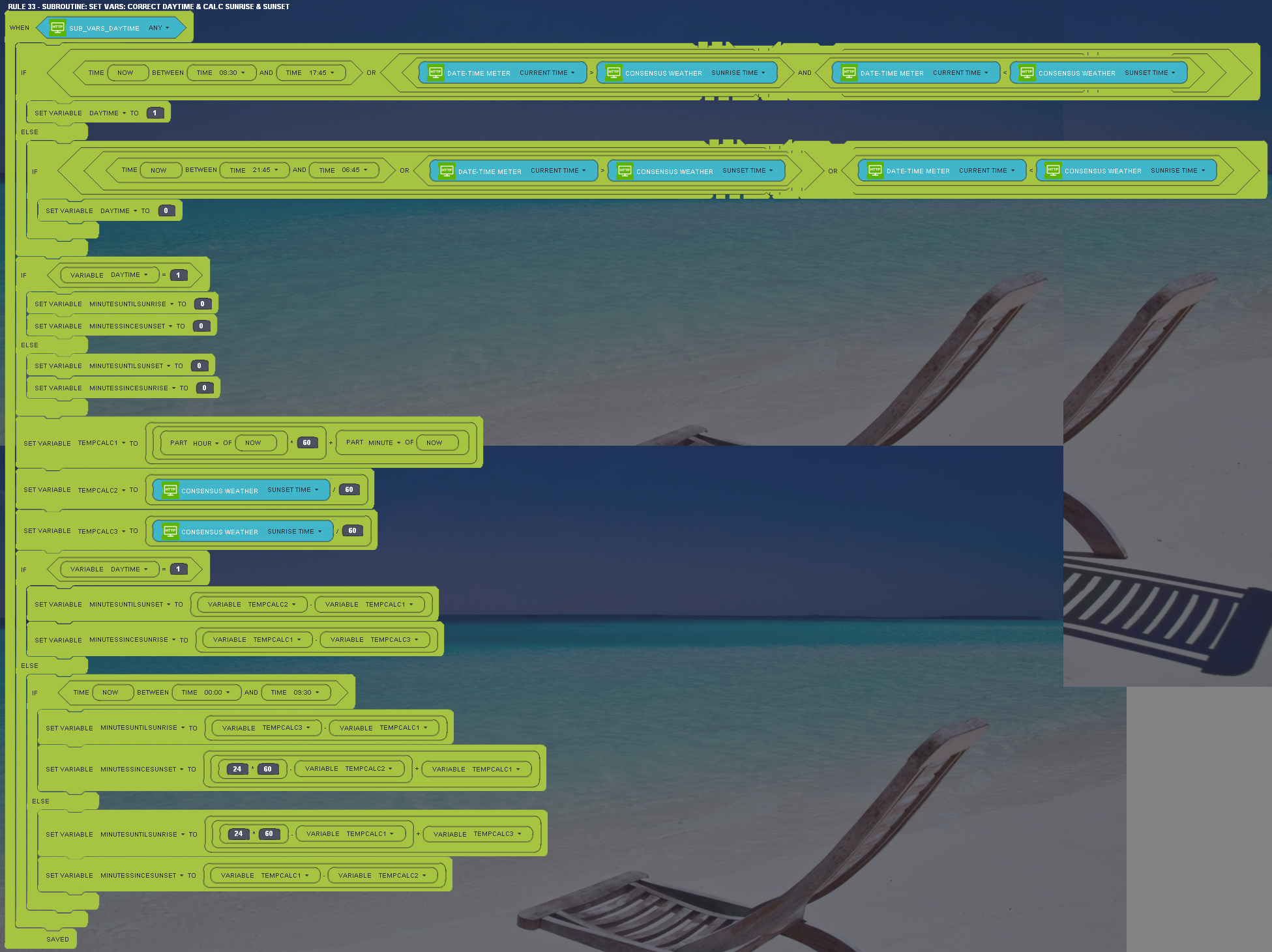

The sunset and sunrise times are time values in seconds. I posted elsewhere about my date-time meter. Basically it has a date value measured in hours (inc. fractions of hours) since 1/1/1970 and a time value in seconds. I convert the sunrise and sunset
times to compatible values so I can compare them.

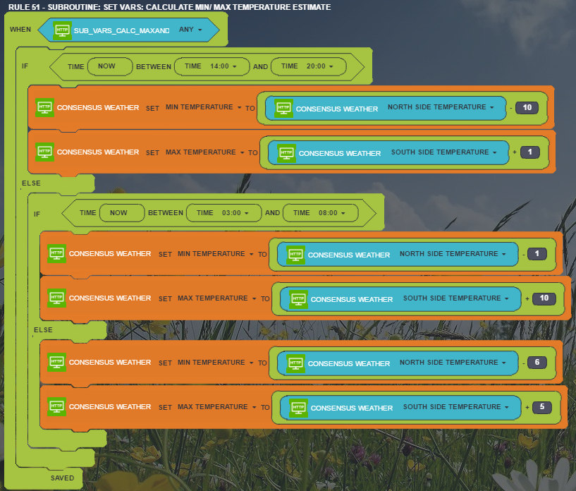

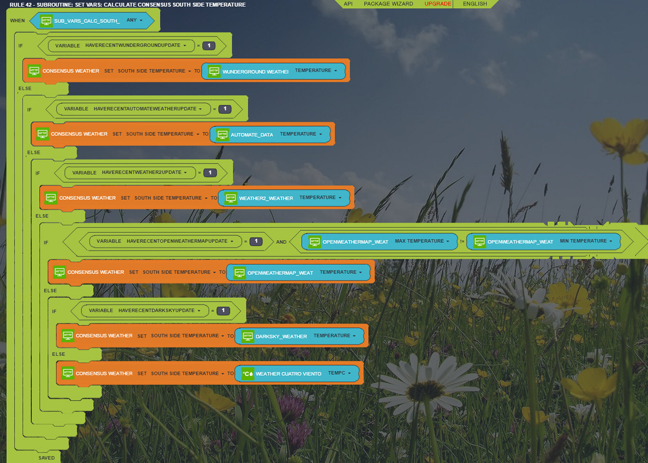

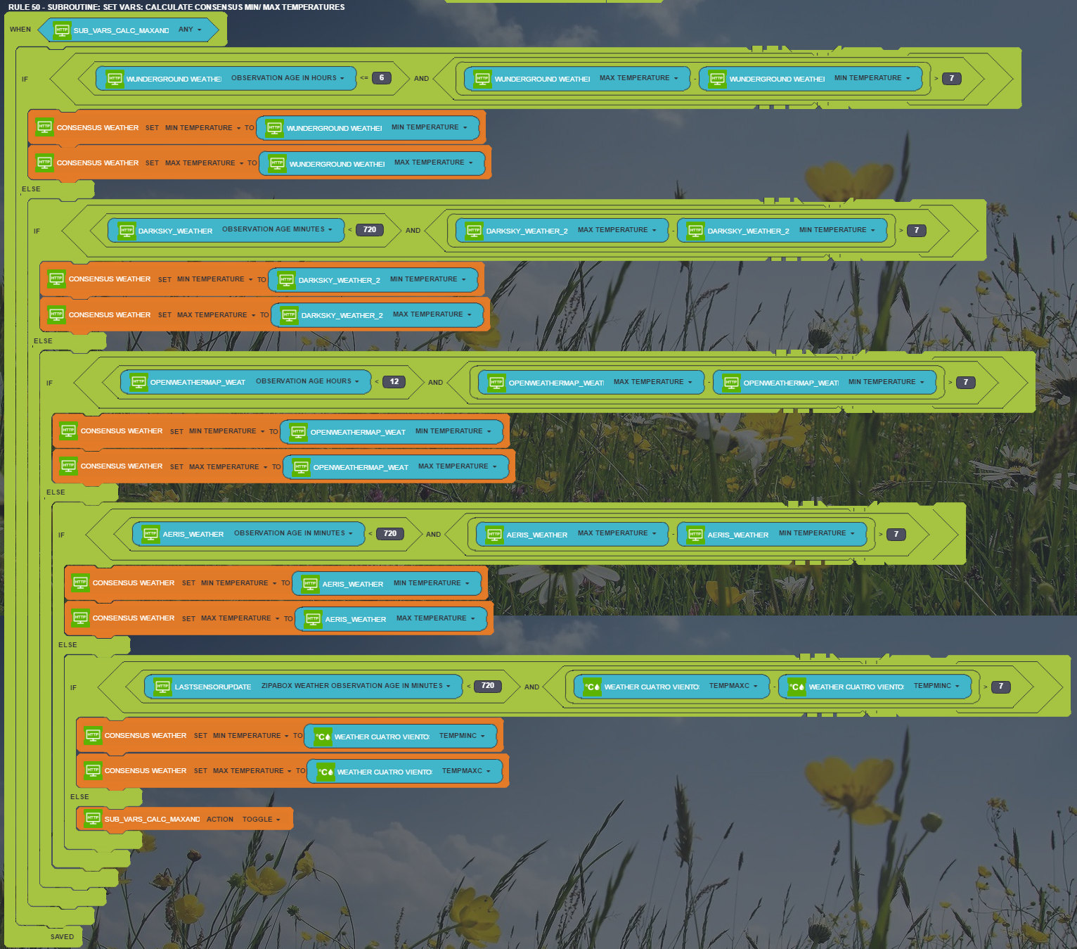

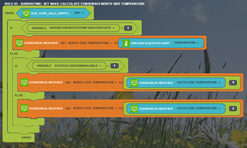

The north side temperature (where there's little sun) is taken from a sensor I have, unless the value is outdated, in which case I take the general temperature value and adjust it downwards a bit.

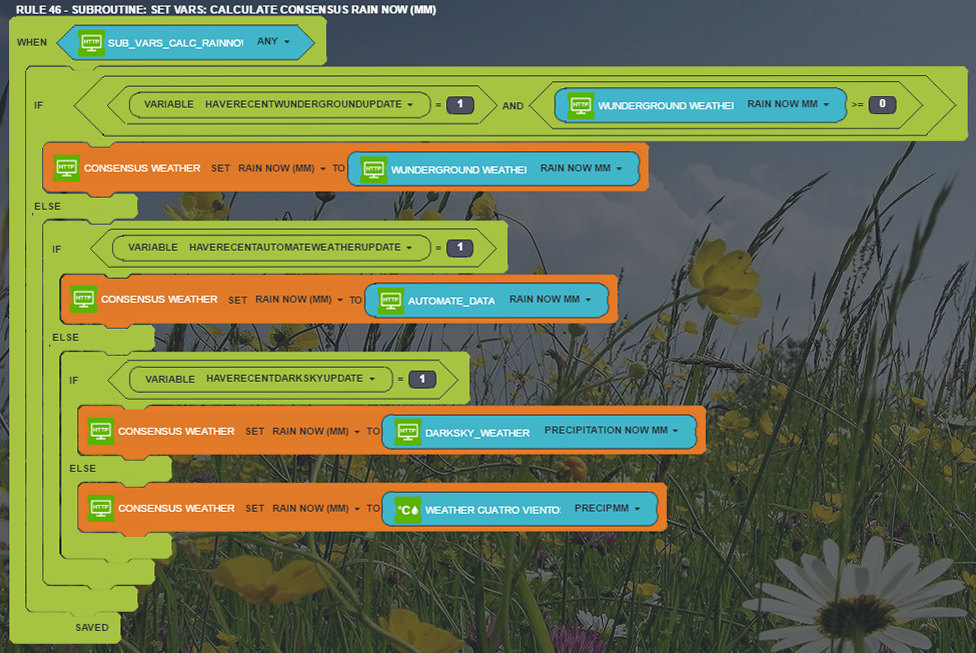

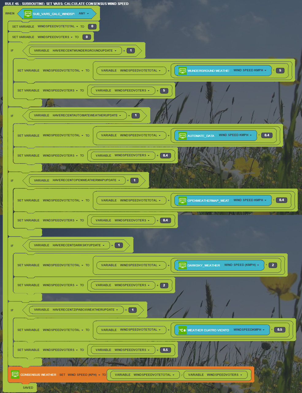

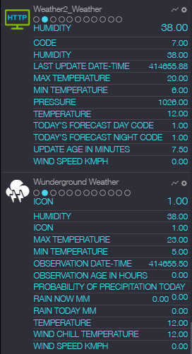

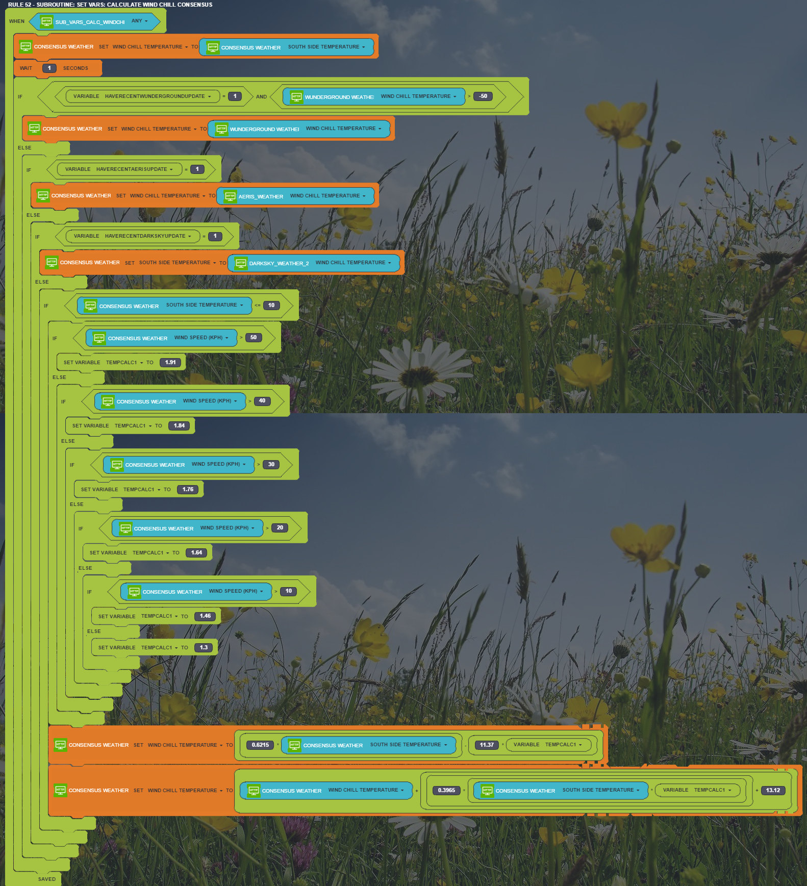

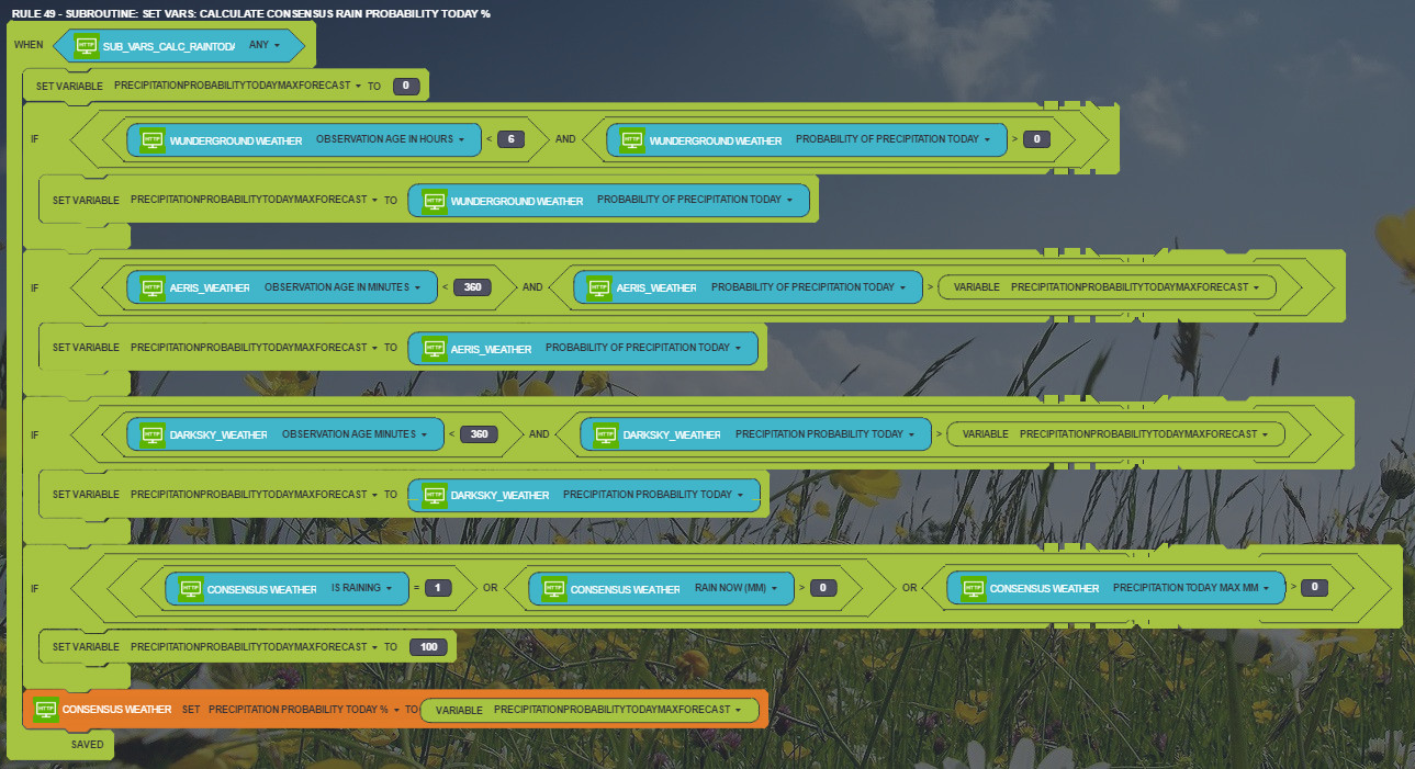

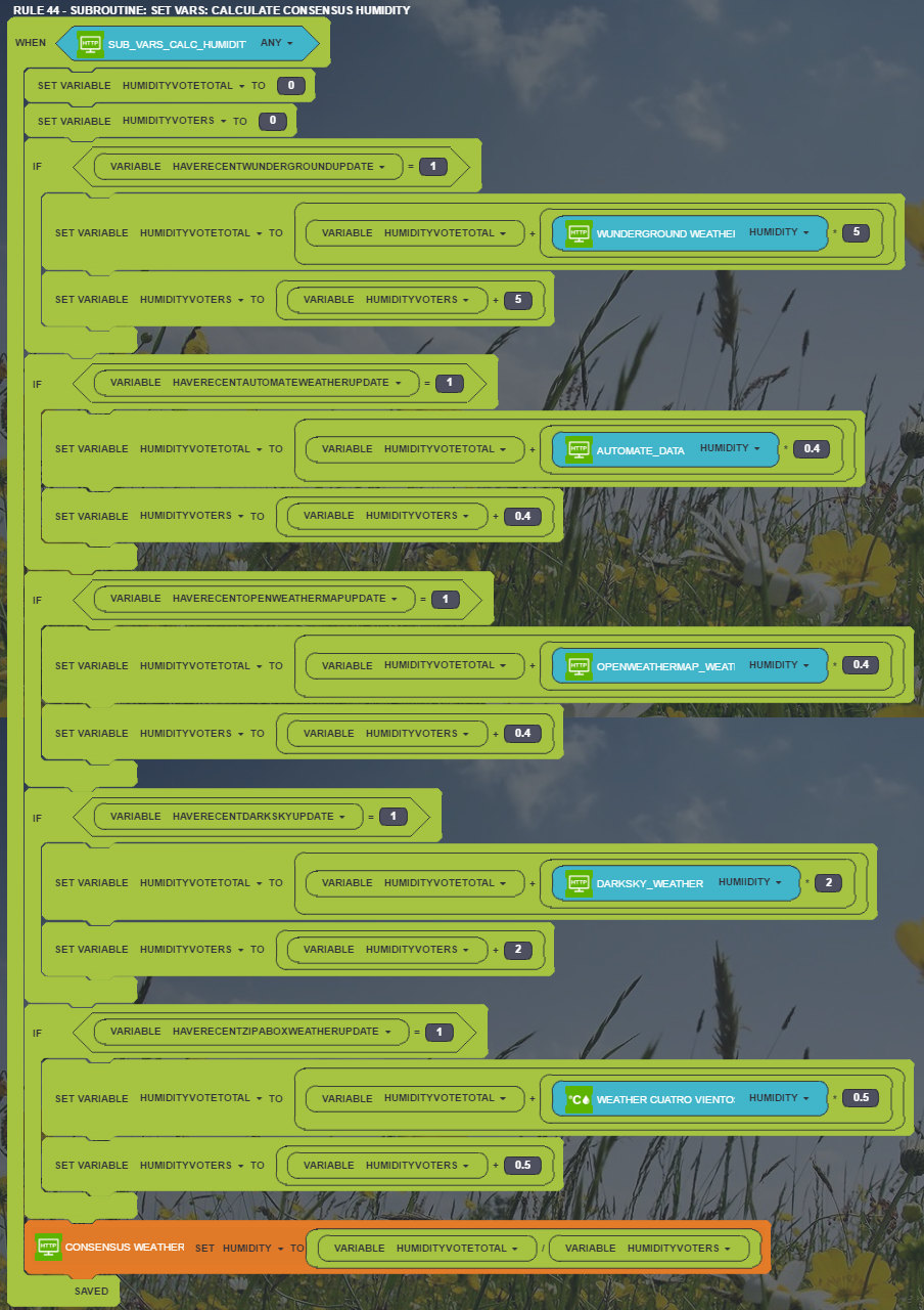

For some weather values, I just take the source I consider to be most reliable for which I have a recent update. Wunderground seems to be the most accurate for most of the values, but as with all the weather sources, you need to be careful about null values. Sometimes min and max temperatures are the same, or there's some other obvious error. I try to filter these out in my rules. For other values, I calculate a value incorporating all sources, but weighting the ones I like most.

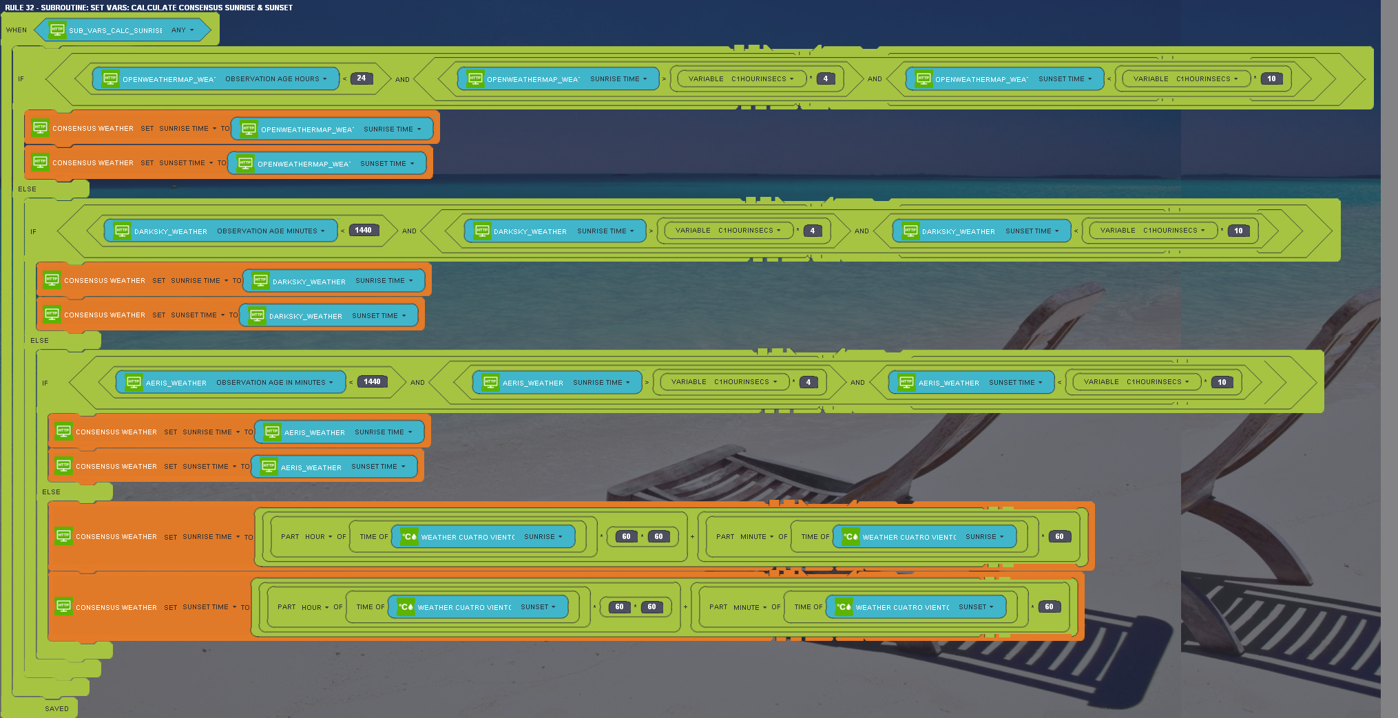

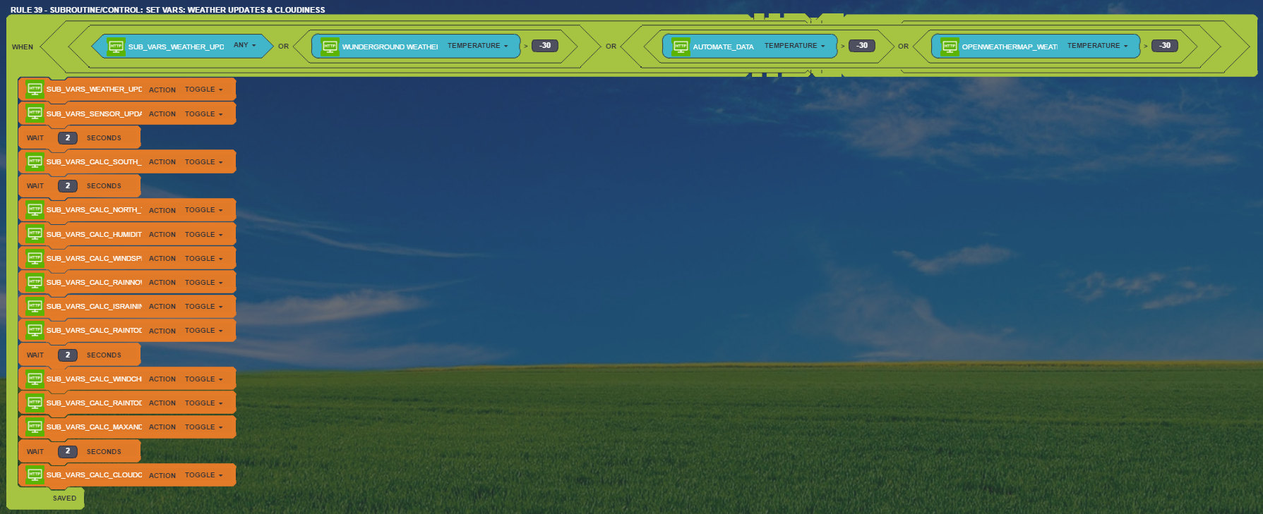

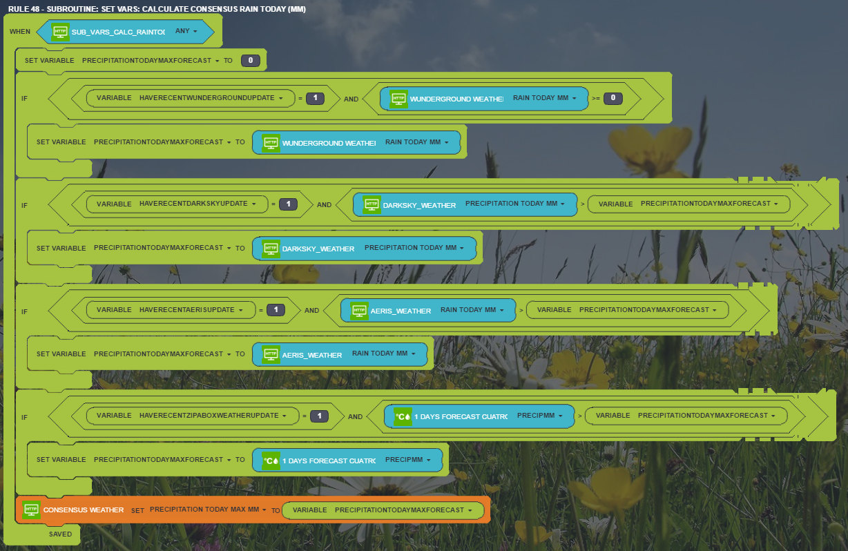

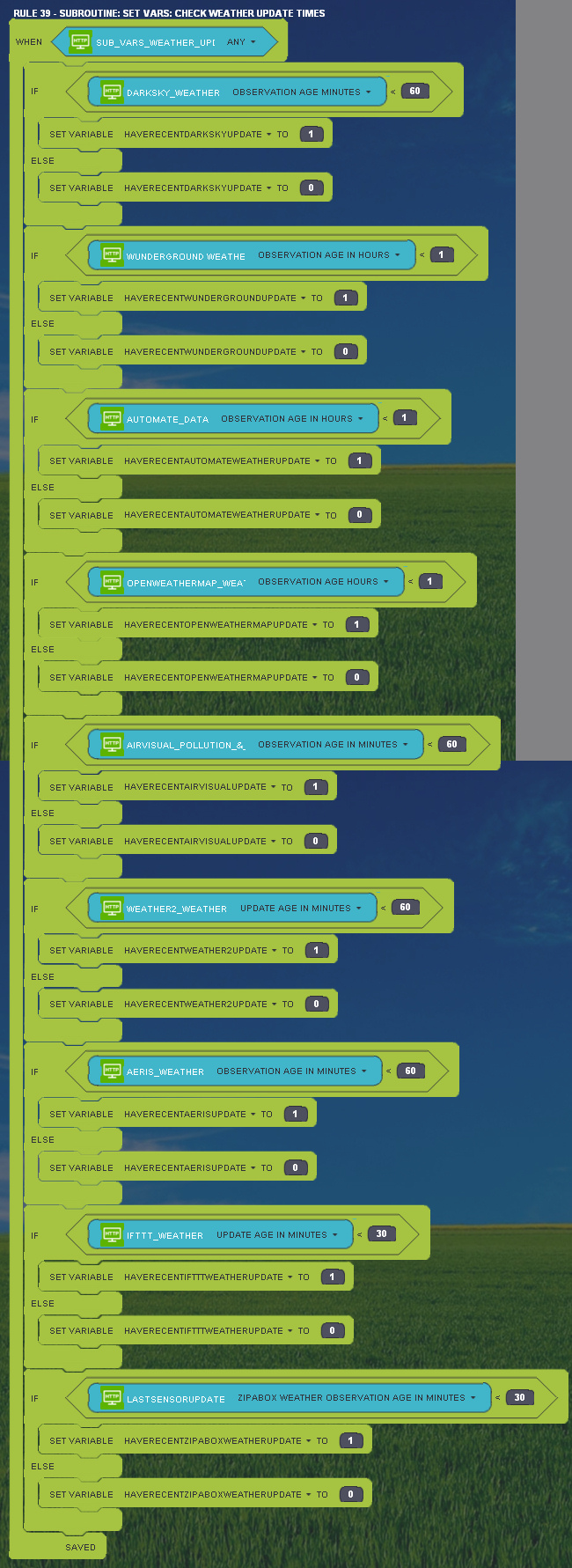

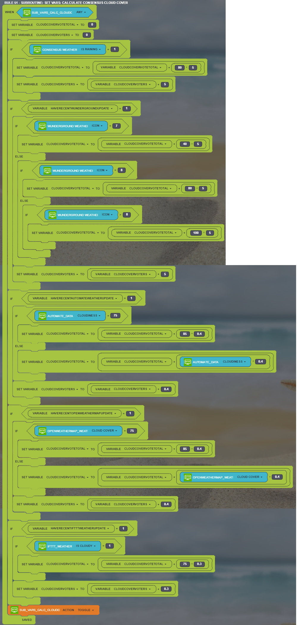

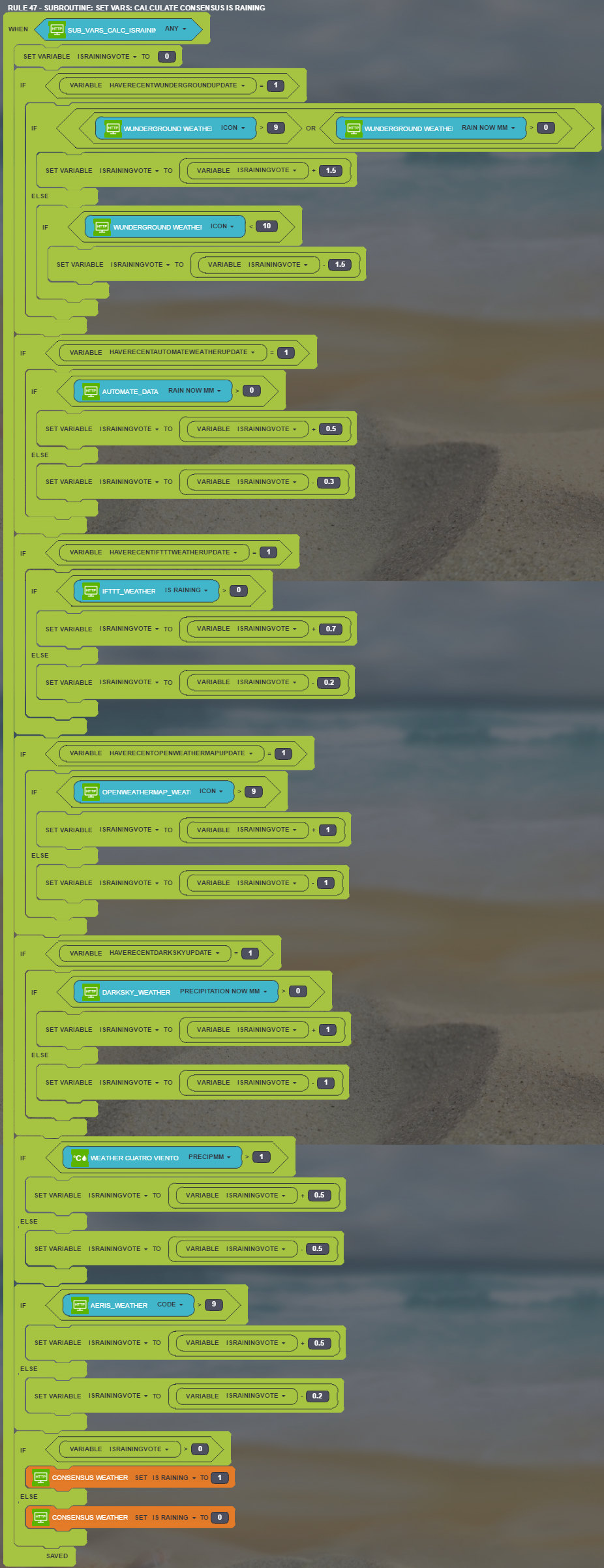

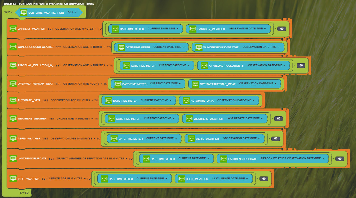

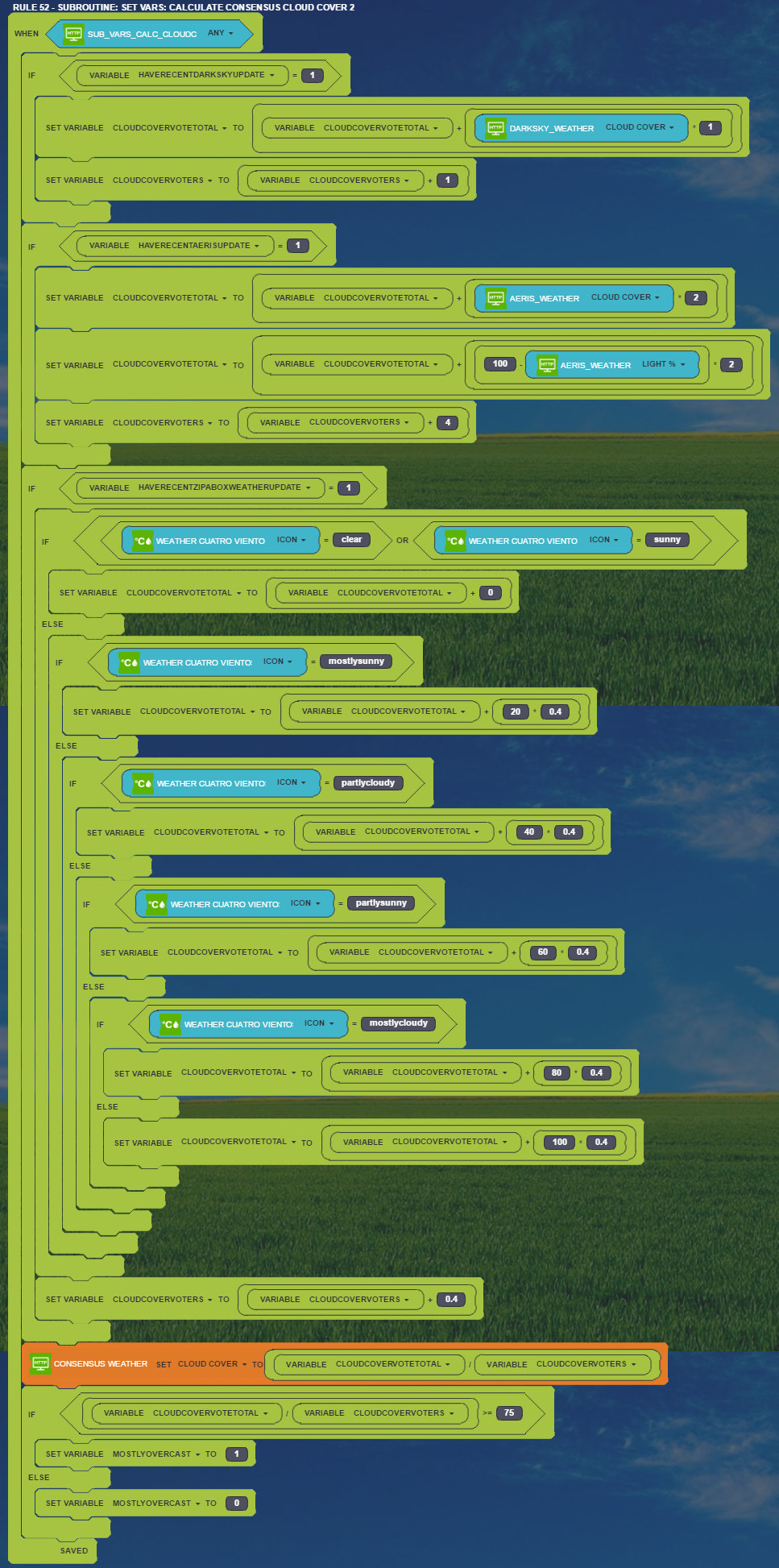

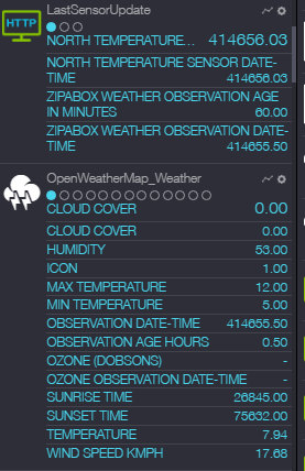

Each rule has a virtual switch to trigger it. Because of my long names, the names are not always visible. "Zipabox Rule 050 - Subroutine - Set vars - Calculate consensus min-max temperatures" calls "Zipabox Rule 051 - Subroutine - Set vars - Calculate min-max temperature estimate" at the bottom. "Zipabox Rule 052 - Subroutine - Set vars - Calculate consensus cloud cover" calls "Zipabox Rule 053 - Subroutine - Set vars - Calculate consensus cloud cover 2" at the bottom.

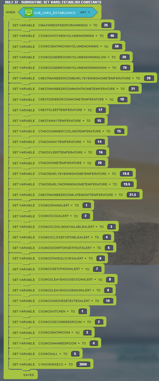

I also attach screenshots of my virtual meters.

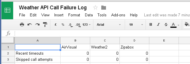

I forgot something. The script uses a Google Sheet to record failures when calling some error-prone APIs, such as AirVisual and the Zipabox itself. I do this to prevent many calls being made to APIs that have become unresponsive for some reason, because the long timeouts end up chewing up your entire allowance under Google App Script for the day, which then knocks out your entire system. So I record the failures and, the more consecutive failures are recorded, the more calls are skipped. So when a particular API goes down for several hours, the script will only try a few times and then leave it alone for a while.
My script is set up to run every ten minutes.
Those consensus weather rules are also run every ten minutes.
Here's a screenshot of the Google Sheet. You can easily extend it to add more APIs if needed.
