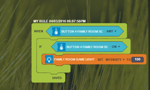

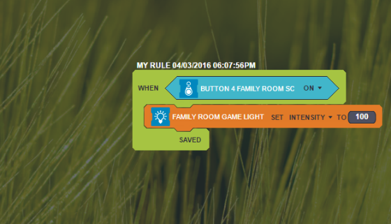

I'm still learning the Zipato and am trying to setup my Cooper 5 button scene controller. I added the scene controller to the network and the only way I see to associate actions to buttons is through the rule creator. I've tried both of the attached rules just to turn on a light and neither rules work. I've also noticed that most of the buttons only turn on temporarily, button 4 is the only one that keeps it's on/off state.

Example of how you could do. To make a light toggle. You can also just make a scene turn on.
Jacob - thanks for the suggestion.
Unfortunately this configuration doesn't work either with the Cooper scene controller. I suspect the issue is how they set it up in the base code. Most of the buttons won't stay on, the same way in my Vera they would act prior to being assigning a scene. On the Vera the setup language reports that it's creating associations when I assign it an initial scene, which makes me think you have to do an association vs. a rule.
