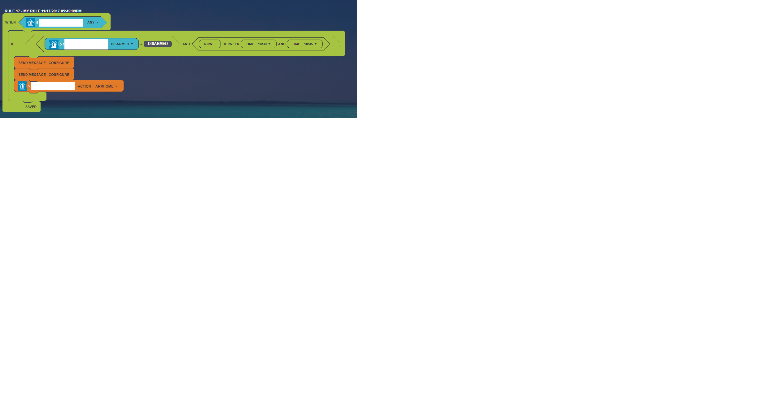

what am I doing wrong?
I started with the auto arm at 11:00 as I have no clue where to start with the virtual sensor
Ok, firstly, you say you started with an auto arm at 11:00, but your attached rule has the time frame 6:30 - 6:45 pm.

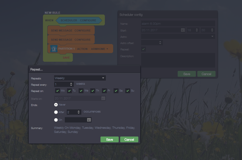

When creating a rule you need to remember that you need a trigger, a change in state or update in state from a device. If your device stays in the same state, it will not trigger an event(rule). ei, in your rule you are waiting for a change in the alarm state, then the rule will check to see if the alarm is in the disarm state, and between the times specified, then it will send messages and arm if all criteria is met.See attached example for arming your alarm at 6:30 pm. You can change times, days and even use the sunset and sunrise with astro offset with a scheduler.

ok got auto arm working....I wasnt using the scheduler properly....thank you!

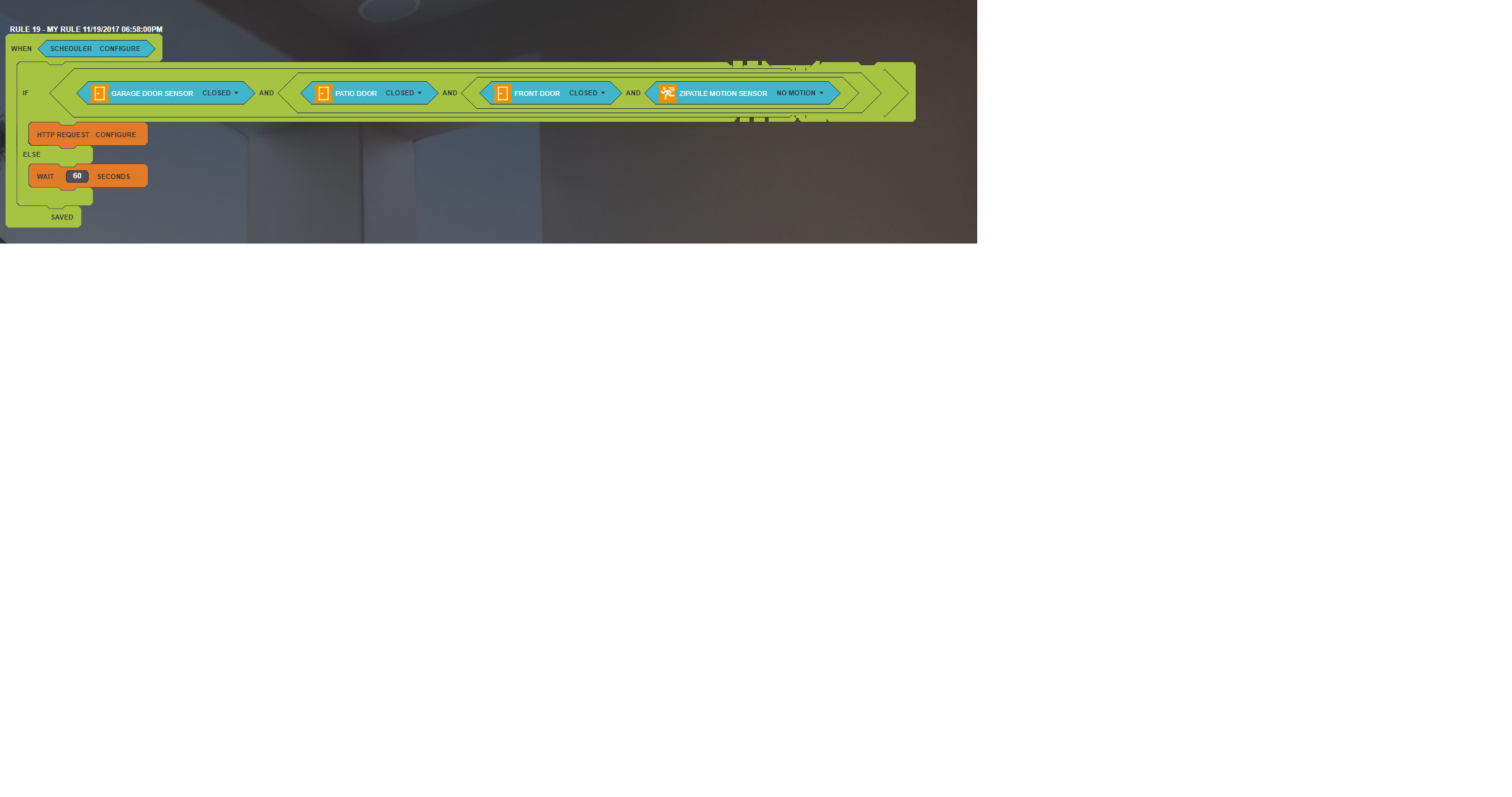

got virtual to turn on with this ....until I put the wait in
?????? WTF does that do? What are you trying to achieve here?
I was testing the virtual sensor/switch as I am new to this and wanted to go step by step. It worked until I put the wait in there....which was to wait until closed or no motion (I hadnt added the arm yet) trying to do one step at a time. Sorry I am clueless on some of this.
