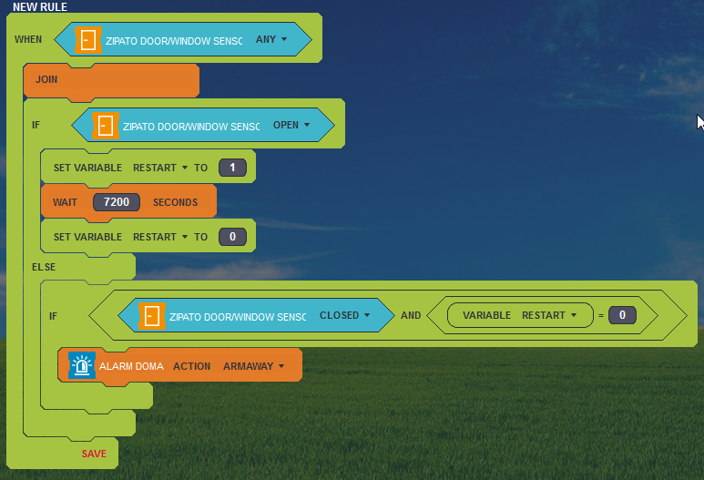

Anyway find a sample rule. In this rule if you open the door, it will wait 2 hours (time can be changed as per request) before will consider that if you lock the door, it will arm or not but it will not really work, because when you leave home, you open the door...perhaps it would be better to set up the inhouse entry motion sensor and set up the rule that if the door is locked and there was already motion it means that you were leaving the house and can arm, however if there was no motion then it will not do anything as you probably arrived to an armed house.

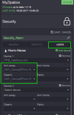

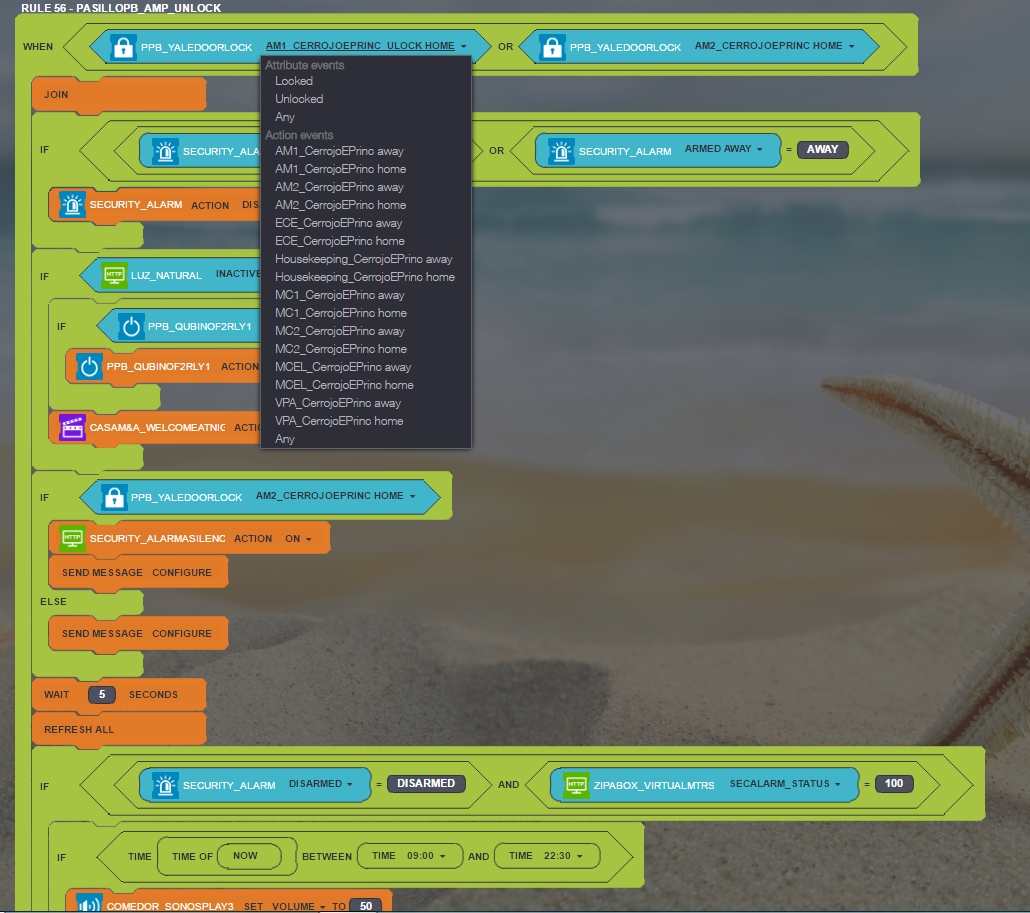

I have worked on Auto Disarm and Auto Arm functions and have Yale smart locks, these locks have events specific to lock/unlock using user's password or you can interrogate the controller for generic attributes, in the attached screenshot you can see the three generic attributes (don't really understand why there is a any attribute, to me it should be only an event) these will be true every time you open or close the door accordingly every time, regardless if you used the password or lock it from the inside.
On the events you can see how each user has two events, Home and Away (which are not related to alarm HOME and AWAY mode, home in the Yale lock means that it was locked and you used your password to unlocked, away means that you used your password to lock it). You can use these events to arm/disarm your alarm either using rules or configure them on you virtual alarm (see second picture), so when I lock the door from the inside these events won't trigger and my alarm won't be armed (I use a different approach to auto arm home), the system only gets armed when I lock from the outside using my password.

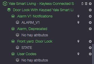

Hi Alberto. I have a Yale Lock with z-wave module version 1, and I would like to know what did you do to get all those attributes, because I don't have any of them. The only attribute that states the las operation of the lock is "ALARM_V1" from the cluster "Alarm V1 Notifications" insider de Lock's endpoint.
