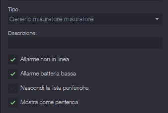

I often visit this forum, looking for informations about the right way to manage the backup module I installed on my Zipabox.
I meet some questions about this topic but I couldn't find any complete explanation, for example about the way to receive a notification in case of power fault.
Does anyone have a suggestion?

Thanks but I'm not succeding to setup the backup module to read the level batery

Well, after some other tests (unusefull), I tried to set this values for the backup module (mine includes the battery) but nothing changed.
When power goes down no notification is sent.
I don't find any "Backup Module Battery" object inside the rule creator.
