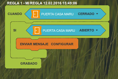

basic and doesn 't work
im doing something so easy, if the door opens the sistem send me an email and i can't make it work.
some idea what's wrong?
This cannot work. The starts if the door is closed and then asked for door is open.
just use when door open
send message....
send message....

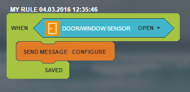

Hello Mortimer84
Remember to use "Synchronize rules" in the top right corner after you save your new rule.
Hello Mortimer84
