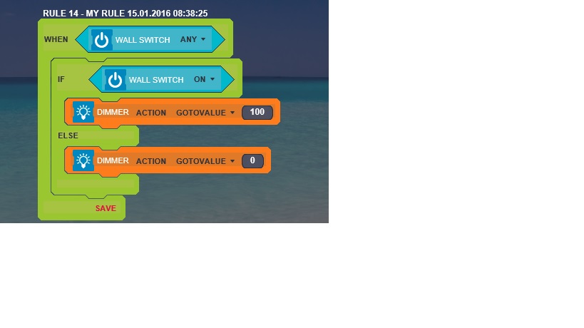

Ok did the rule like this (see picture) will i be able to dim the light like this?
I need to test it tomorrow before leaving to dark now..
yes that should be it

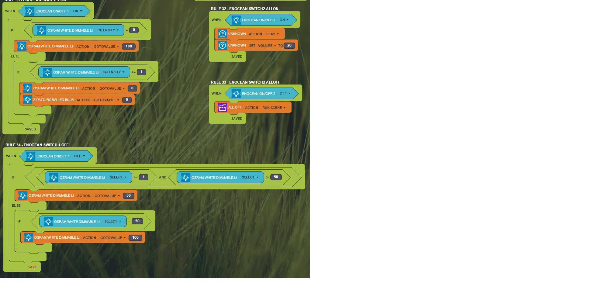

i have one running on an enocean switch(basically same switch) that looks like this.
one button (was) controlling my sonos speaker. One button was an all off scene. One button would turn the light on if it was off to 100%, but if it was on it would turn it off. Giving the button two uses. The last button would act as a sort of dimmer, switching between 50% and 100%. These values could be any value really.
