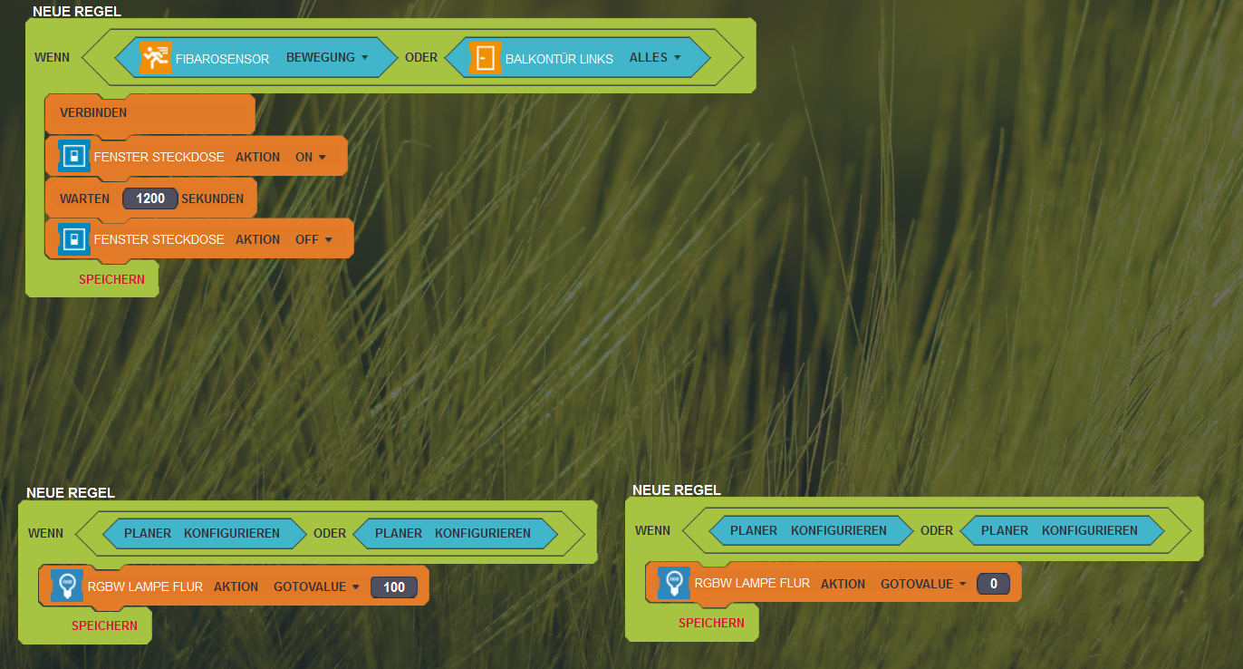

I think those rules should work for you. Can´t try them out right now because the box is installed at my mothers home.
First one switches light on when the door moves or someone moves, waits 20 min and switches the lights off again. I´m not quite sure about the join (Verbinden) command because i usually use it with another If clause. But I think that used to work for me a couple of month ago. If it doesn´t work (the lights go off every 20 min) you need another If puzzle inside the first Puzzle with the same conditions (I think they are stored long enough or you have to use a variable).
The rule for the fishes is quite easy: Two schedulers and two rules, thats all. Just set one scheduler to be repeated Mo-Fr and the other one for Sa-So. Thats it.
